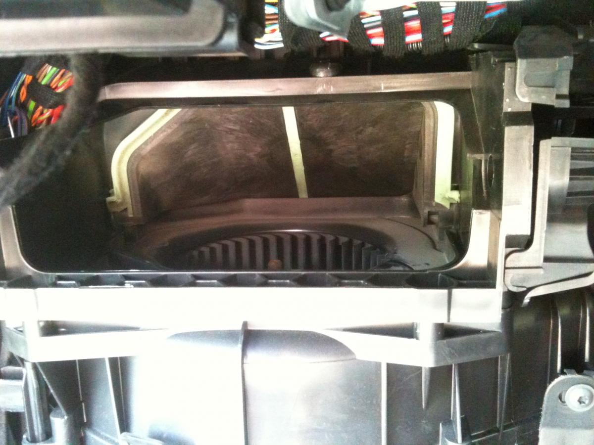

Took the glovebox out today to work on something else I'm doing and, while looking for a way from the cabin into the engine bay (which I think I found) I spotted this...
Thought initially that the pollen filter was just missing as I wouldn't have expected a rotating part to be uncovered.
A little further reading on this forum seems to suggest that there is also a 'sliding' cover missing as well!
Can anyone enlighten me on this missing piece of plastic? - I'll get a pollen filter on order (or go back to Skoda dealer to complain) to get that sorted.
It does indeed look like you have the cover and filter missing

That's exactly how I found it today. Have contacted the dealer who did the last service to see what they have to say about it (but will probably get the usual "It's not part of the service schedule" line).

It was dusty under there, but was about all. The rotating 'fan' mostly. Where does the air actually go?
Past the fan, then the filter and then...
At the moment it appears to blow up the base and sides of where the filter should be. Does the missing housing direct the air to the air con evaporator?
It gets forced through the filter and on the other side is ducting that will direct the air through the a/c, to the flap motors and out through the appropriate vents.
Obviously when the box is sealed there is pressure there, but when it's empty I doubt much force is pushing air through. You should be able to confirm this by setting it to econ and turning the fan to max. point it at the vents and see how much air movement you feel.
sorry but thats just the blower, the pollen filter fits under the air box ,this site shows a mk5 golf and the skoda is the same.
it looks like its on recirculation mode, in fresh air mode the bit with white around it move's forwards and covers the motor/blower
