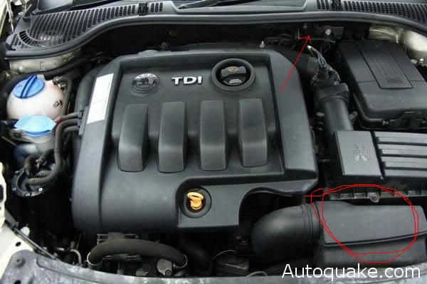

Was completely hacked off with the car, but on deciding to clean it at the weekend, I thought I'd pop the bonnet and in doing so immediately noticed that something wasn't quite right. (In my defense, I haven't actually looked under the bonnet to see if anything obvious was wrong as having had the car in for a service, and Skoda having looked at it numerous times I wasn't expecting to see anything).
Anyway, I noticed that there was a cover missing from the air scoop behind the grill and therefore the air wasn't being directed down the pipe and through the air filter. (see red circle in image, ignore the red arrow).
Was quite surprised that something so blatantly obvious was missing - I'm far from mechanically minded and noticed it straight away. Luckily I found it wedged between the wheel arch and the engine. Put it back on, and hey presto now the car is running so much better. I say that with all fingers crossed, touching wood etc just in case, but it seems to have done the trick.
Guess it must have been left off by Skoda when it went in for a service, I can't see that it would just fall off as you need a screwdriver to get it off. Have to say I'm pretty disappointed that they never found out what's wrong...
