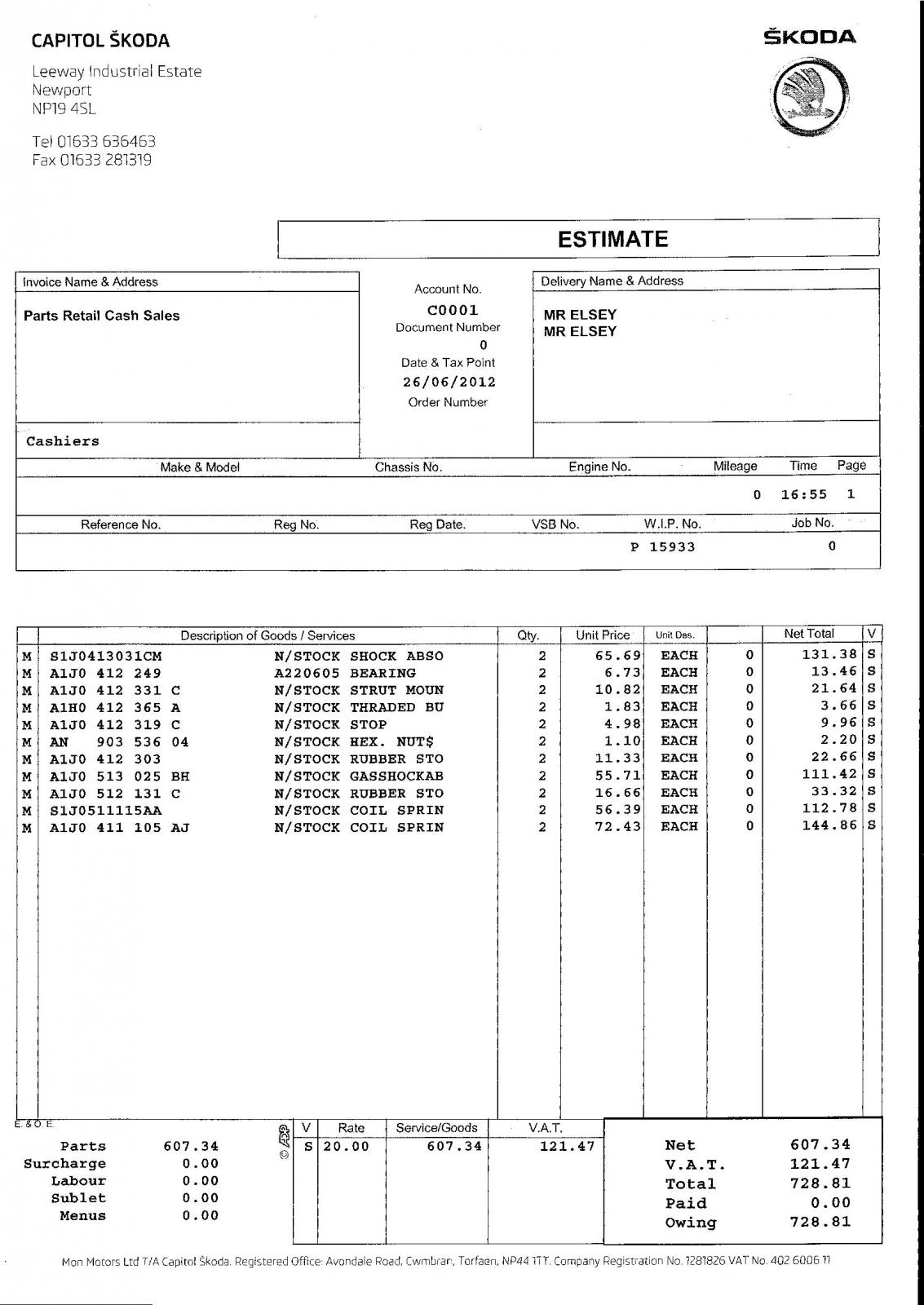

Sorry maths was never my strong point here is the quote from Skoda
few lol, thought you were getting ripped off there mate.
That sounds not so bad but for £600 for just the stock shocks n springs you can get weitec coilovers and the OEM Bearings x2, Threaded Bush x2, Top Mounts x2, rear Bumpstops x2.
Have that at stock vRS hight and it will firm it up but not be too bouncy or harsh. you also have the coise of lowering it later if needs be but again you will compromise on ride big time the lower you go.
hence why a lot of people go coilovers. I wouldnt get anything cheaper than Weitecs tho personally.
