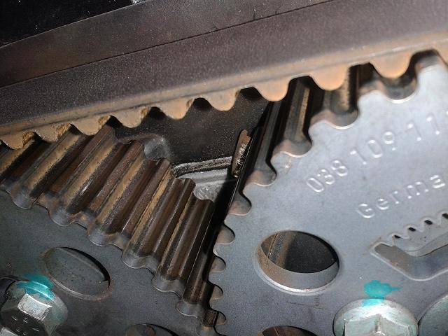

But what do you think about this cambelt? This is a genuine part from a BKD engine. It looks like a rusty cambelt. Is this normal for a 1.5 year cambelt and for less then 50k miles?
