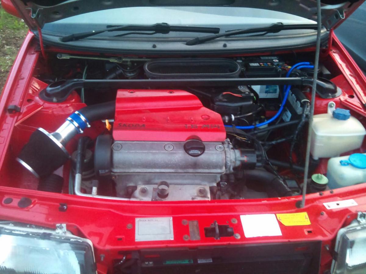

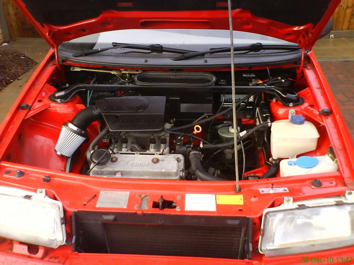

i need some help been working on my Felicia done all the other stuff engine+air con conversion now fitted. All inside swaped dash seats door cards mirrors cl even got a sun roof lol saves the petrol . both air bags (WORKING) i think not going to see if they do.

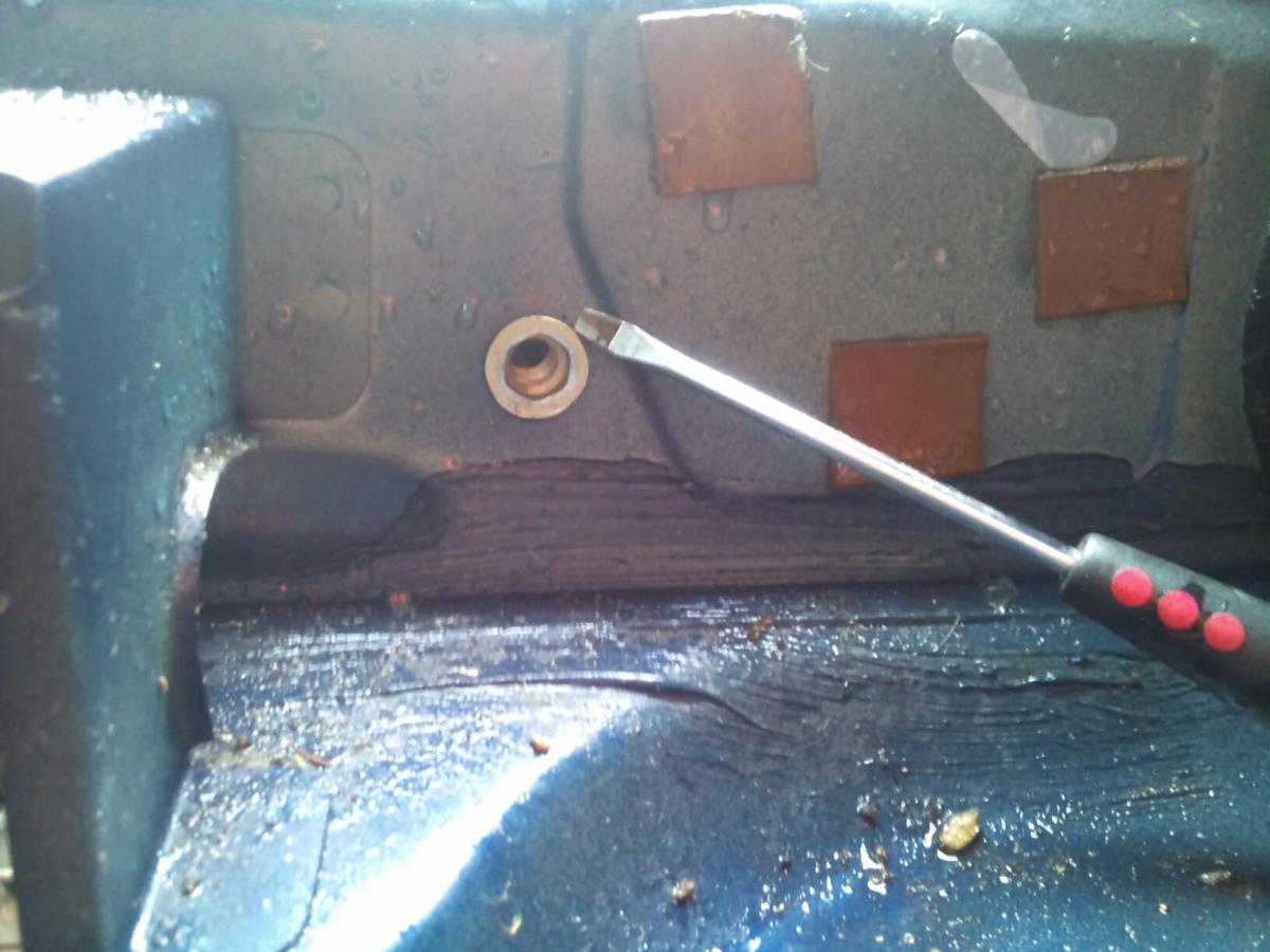

Started to put the seat belts in with the tensniors but have no captive nuts for tensniors (i think thats what they are called)
Can any one help me as i am looking to sell my baby soon as family getting bigger so need to sort this out before i sell it every think else is done
Do SKODA do them???
here is a pic of the part needed and a before and after pic of conversion

If you've not got an account on the Vagcat boards mate, make one (dead quick) and check out THIS page in the parts catalogue. If I had to guess from what you've told me I'd say the part you're after is #: 6U0867276B, kind of like an expanding captive nut for the seatbelt pre-tensioners?
Presuming Skoda have one somewhere I can't imagine it costing anything more than about £1.50
Found it to be 6U0810999 hexagon nut, shouldered M8 so will go and order 2 tomorrow from Skoda if they have any
Thanks
