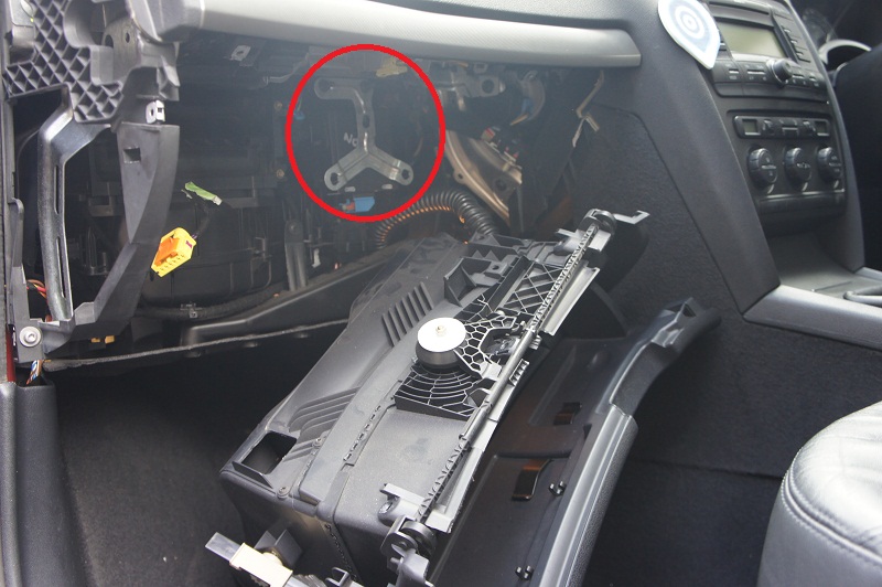

I'm just posting this for reference, as when I was searching there was plenty of useful information on the forums to help me replace the CAN gateway, but a picture is always useful. Hope it helps someone out.
Attached is the location of the CAN gateway on a pre-FL, Mk2 Octavia, RHD.

Ditto what he said!
If mine was behind the glovebox it would have been so much easier.

Thanks for sharing the info, I have a pre-FL too and am soon going to upgrade my CAN. I thought mine was behind the Dashboard, but now I know where to look.

As per the posts above, it appears the gateway has been moved after 2007 models to behind the dash. My car is from Dec 2004. Glovebox is easy enough to get off anyway if you want to check.
Mines an early 2007 (April registration) and that is driver's side. I haven't found anyone as yet with an earlier car that is that side.
2006 06 (March) and mine was behind glovebox
