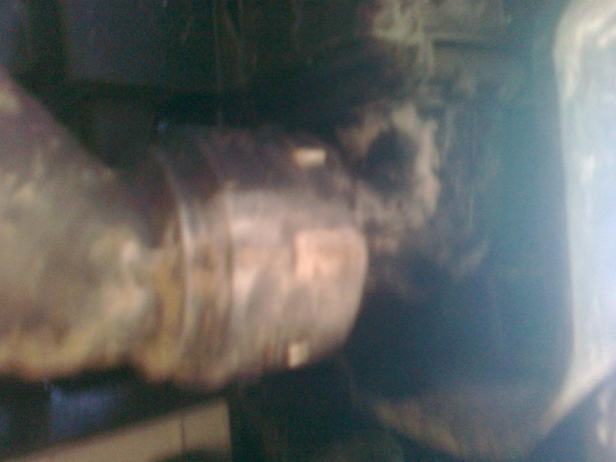

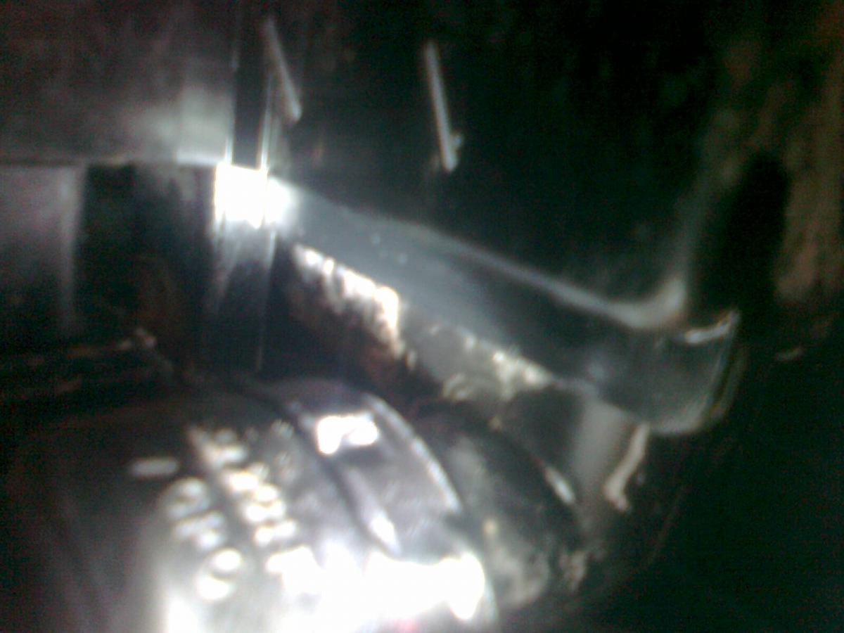

Well I took the engine tray off the car tonight and had a good look around the bottom and the radiator. It seems to be eaking out of where I was told yesterday. Couple of pictures I took on my phone so you can see for your self. It also seems a little bit higher up than the pipe in the pictures but maybe this is blown up the way when driving the car ?

Where the leak is it amost seems as if there is a seal possibly?
Sorry in advance about the quality of the pictures, Its the hose that runs from the front of the engine block down through the centre and round the back into the bottom left of the radiator, pictured)
