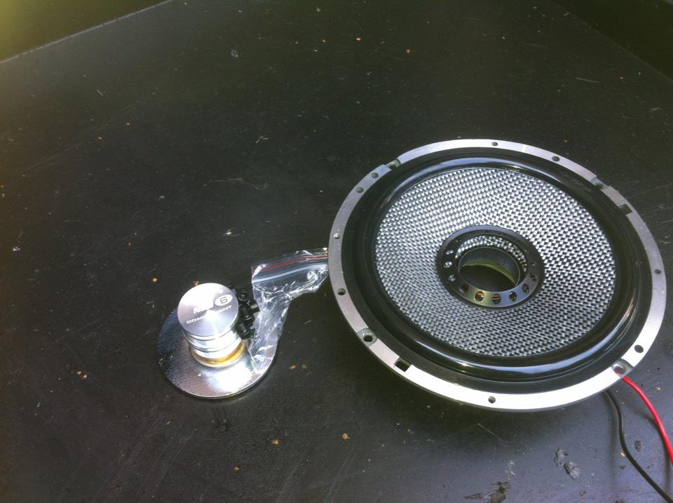

If you look at the file attached, you will see a picture of what my speaker looked like when i took it out (the one that stopped working) has anyone ever come across this before or seen anything like it?

As for the Vibe Litair6, don't even bother with them. They seem to be held together by some sort of glue? shown in the picture above, they fall apart. Has happened to a total of 3 now and counting which as you can imagine is very irritating and not good. Contacted Vibe for an explenation and they said they will inform the R&D team to ensure this can't happen again. They are Sending me Blackair 6's as a replacement however thinking of it, don't think im going to be happy with them due to the reviews not being as good. Would like to have gone with the Space components however they seem to be on the deep side which the door won't accomodate
