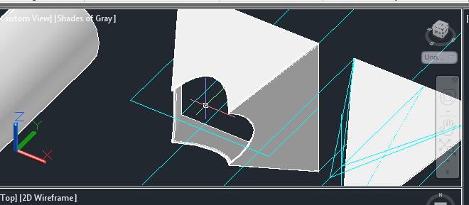

A small update.
Cading work in progress
By having it all designed in full 3D I will have data ready for future CAD/CAM machining if needed and for now I will use it to print out 1:1 templates. Hence my earlier reference to flat pack model :)
Edited by Jabozuma

Space wise currently it is at 130x130x250 mm of main unit. Two small pumps and a controller will not be a problem as can be mounted anywhere really.
