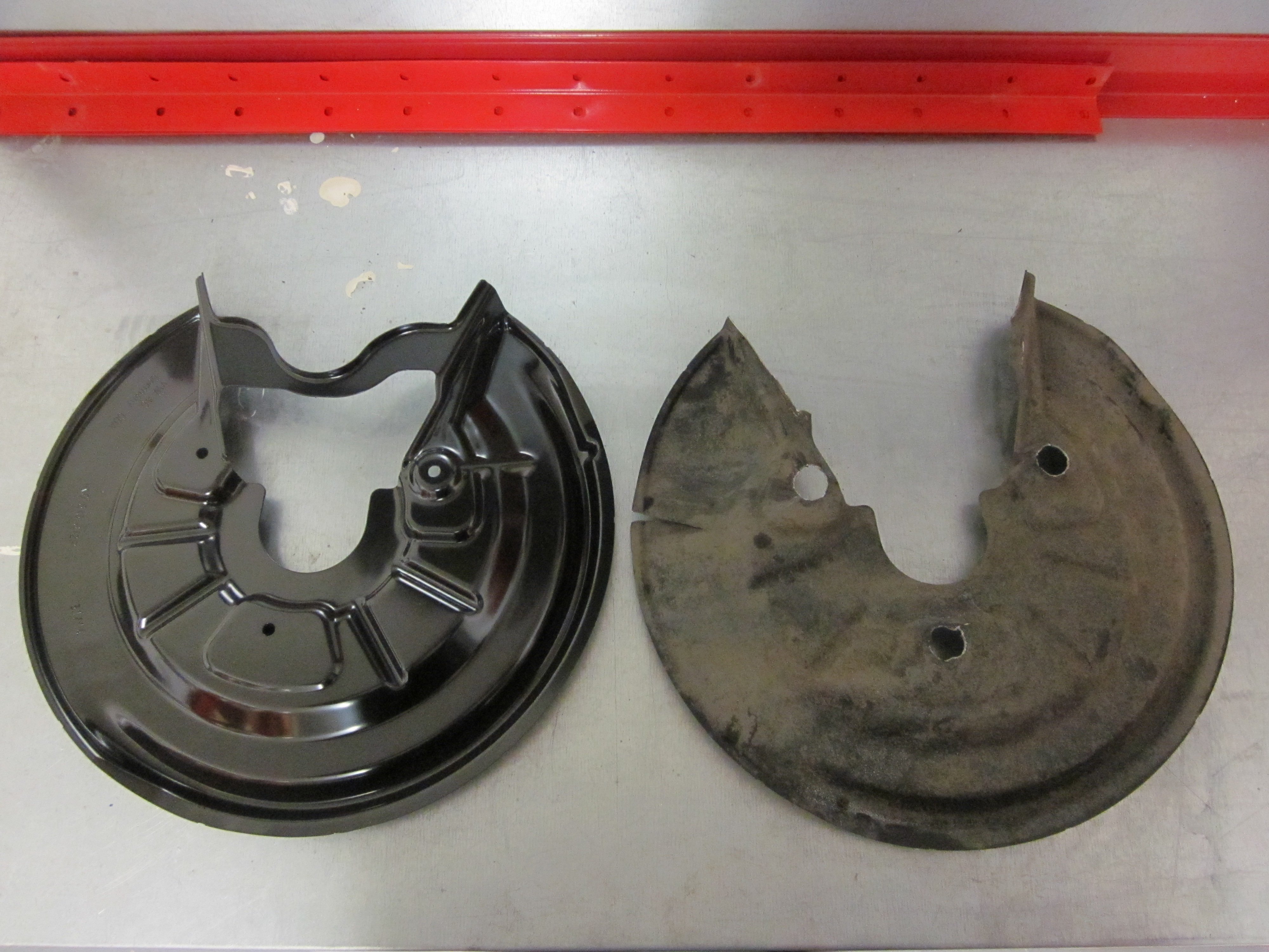

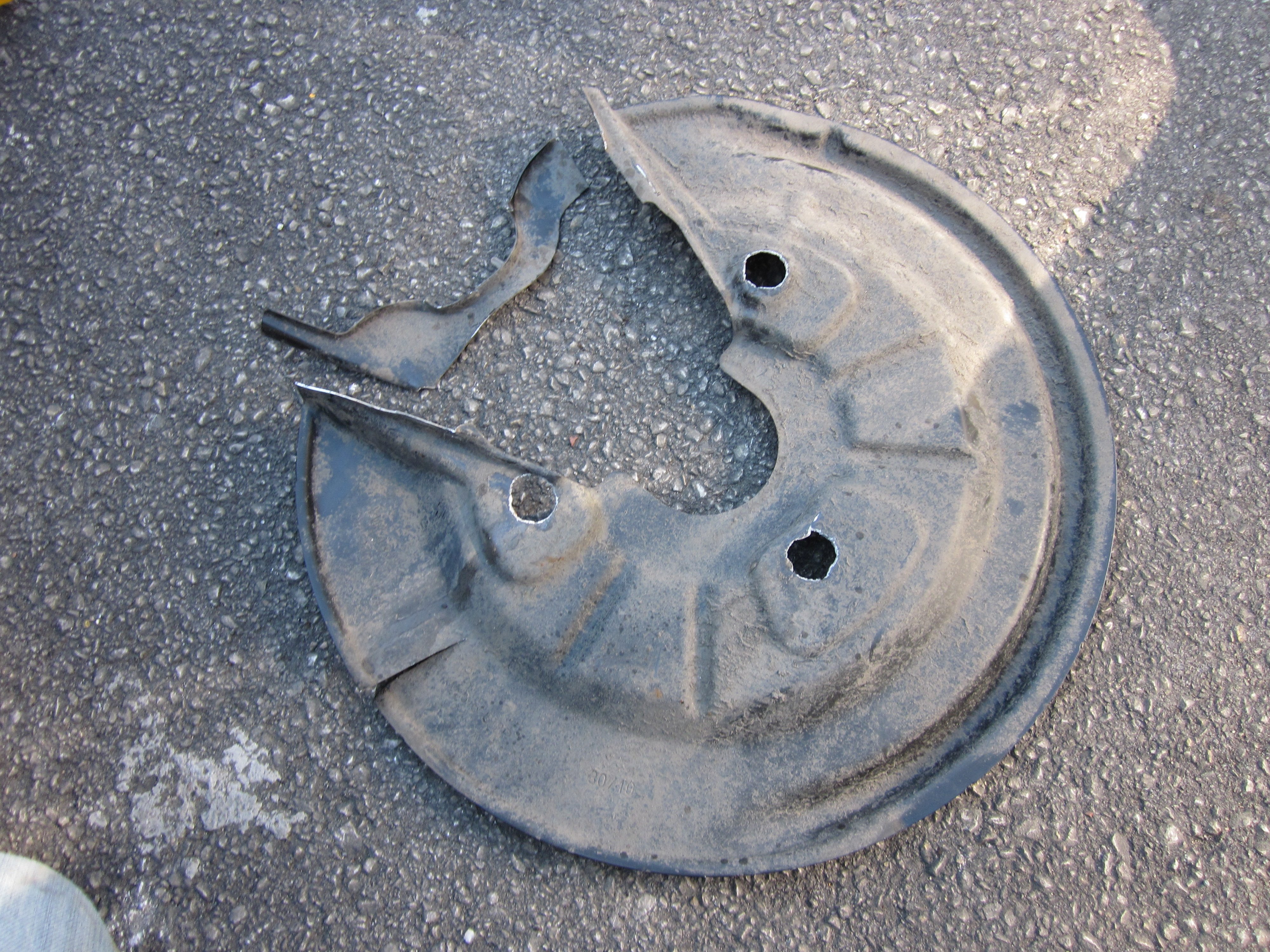

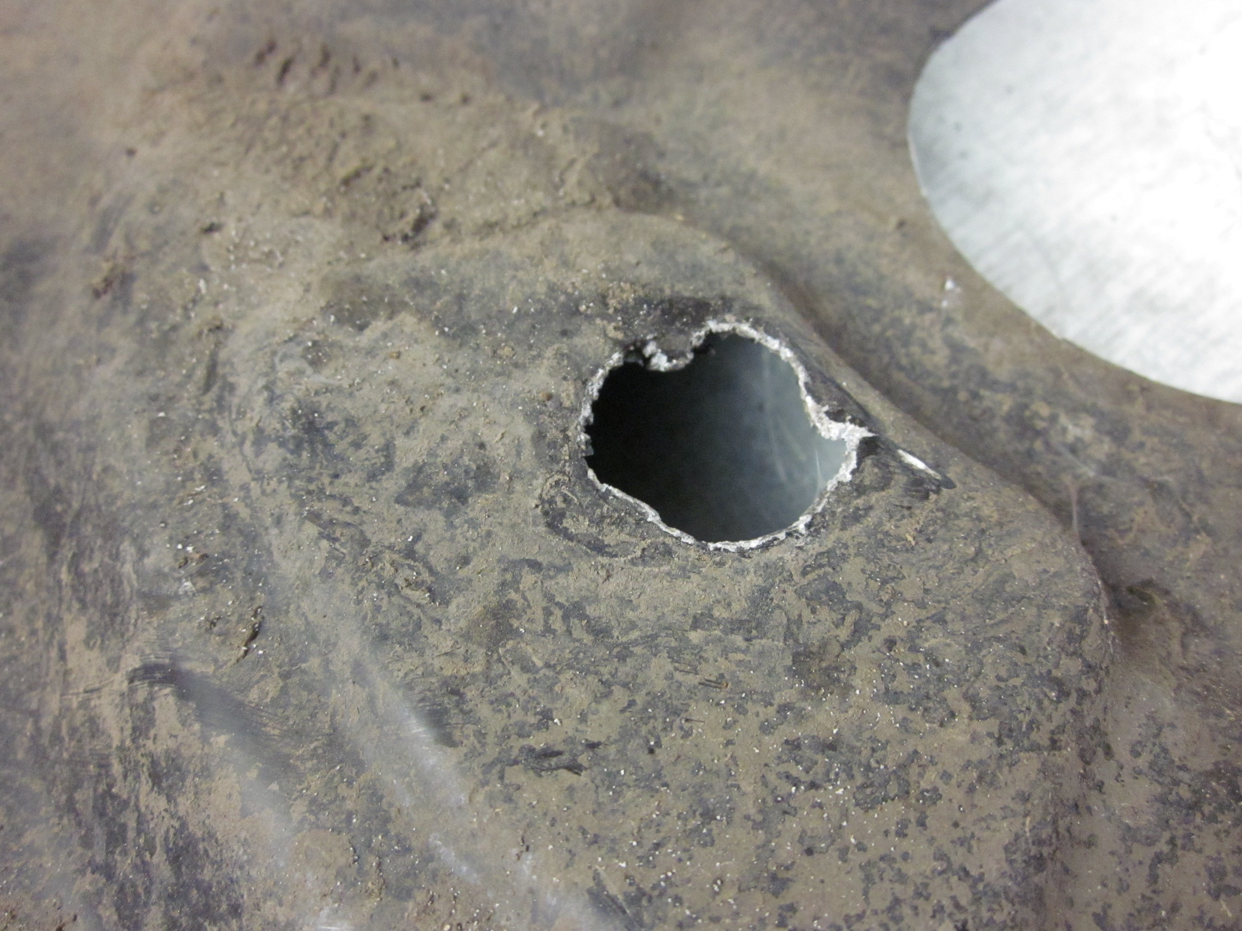

Either a stone or the disc shield. The mounting points for the shields are a weak point.
If they are caught when removing the wheels or you drive fast through deep puddles they bend, then vibrate around the bolts, resulting in stress fractures.
Once they loosen enough they either rattle or fall against the rotating disc.
When mine failed I had to cut them off, unfortunately their design requires removal of the discs...

My 2005 Octavia had an horrendous chuck-chuck noise coming from the back as I drove home last night. When I got home I found that the back plate /  shield had rusted and torn off and become caught inside the wheel. I was able to extract the piece this morning, but of course I now have a car with no shield on one wheel. I've been reading these comments and see that fitting a new one is probably not something I could safely attempt myself, as it involves the removal of the discs. I'm in the process of finding a new car anyway, so I don't want to spend lots of money having a garage fit a new shield (or, more likely, four shields, as you can bet the others are similarly rusted and falling apart). I approached a garage a few months ago about replacing the rear shocks and they advised me to just get rid of the car, as the work would cost much more than the car is worth.

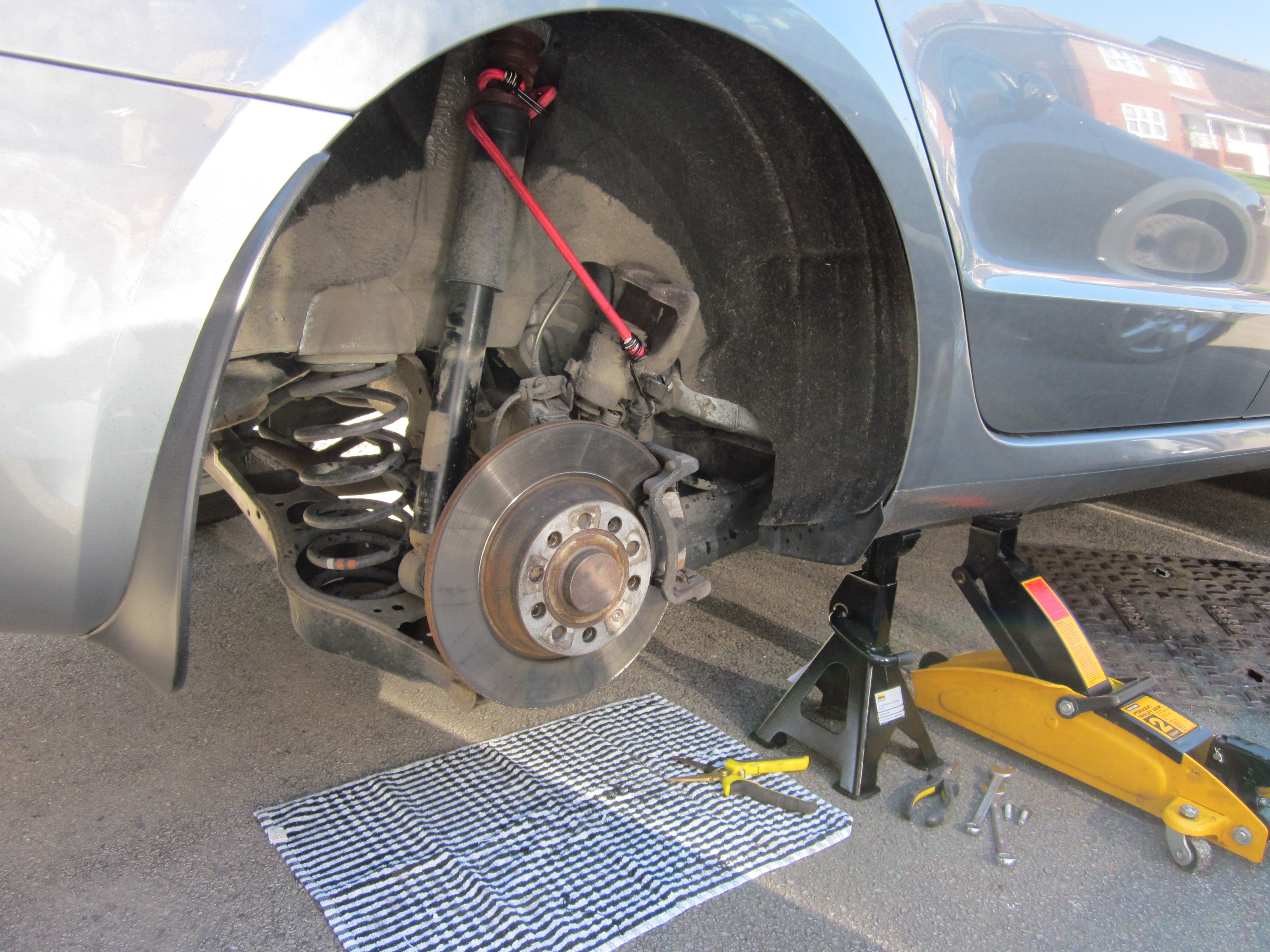

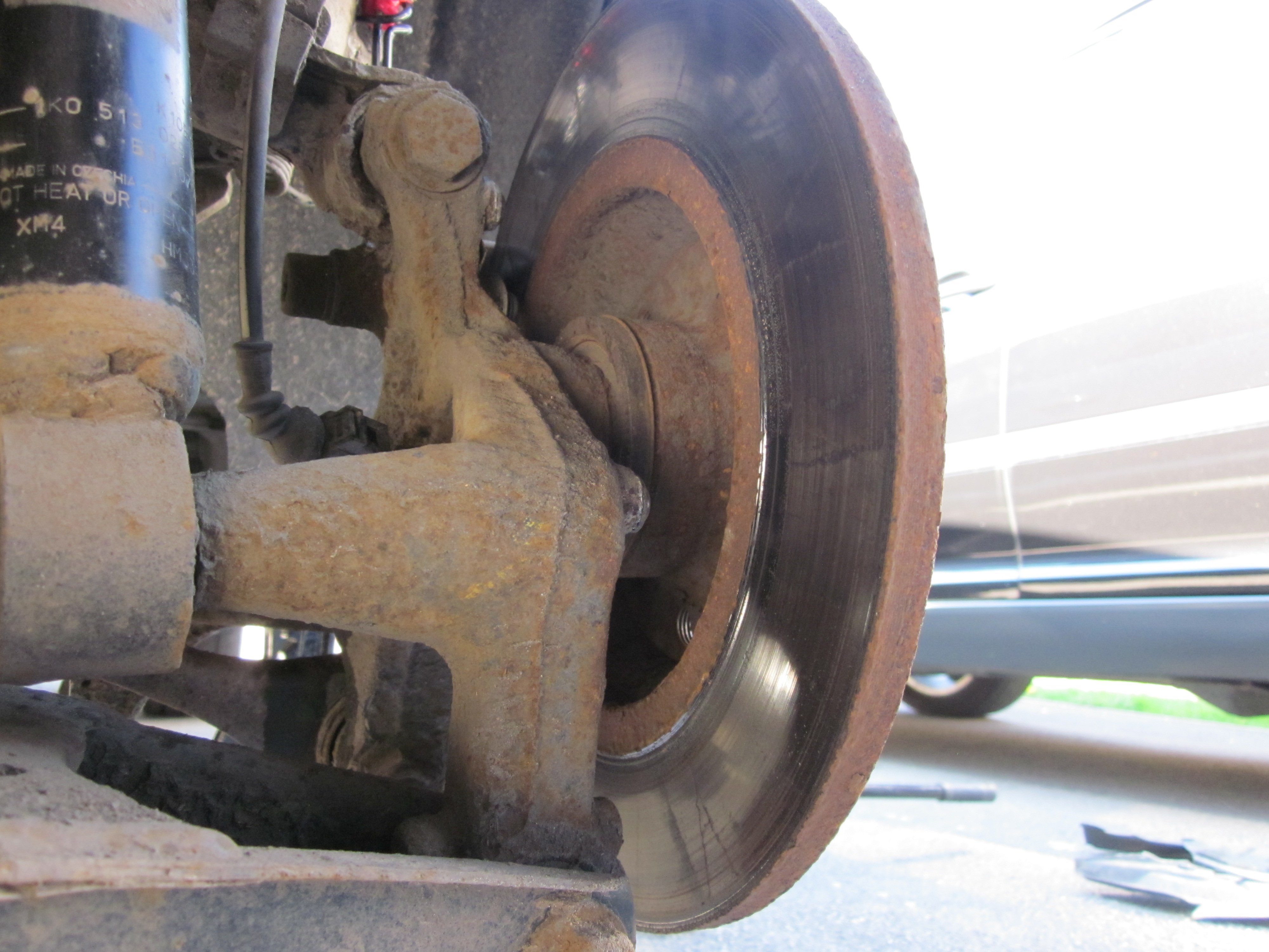

Find another garage or DIY as the rear shocks have to be one of the easiest jobs in the world, only beaten in the easiness stakes by rear spring replacement and rear disc backplate replacement.
If, that is you cut a slot in the old one to remove it as shown in the photos above and make one single cut to fit the new ones, done properly it will be invisible and not lose any rigidity. Otherwise removing the hub is a pain in the backside.
I think the problem that the original garage staff were worried about was the amount of rust. They reckoned that fitting the new shocks would be a problem because the mounting points were so rusty, meaning extra work (maybe welding) to complete the job. I must admit that this vehicle is VERY rusty! Having driven VW Passats for the last few years, I was surprised at how much rust was present all over this car. I knew VWs were good from that point of view, but I thought that over the years the other manufacturers had caught up. Maybe that was one of the cost-saving measures of earlier Skodas.
