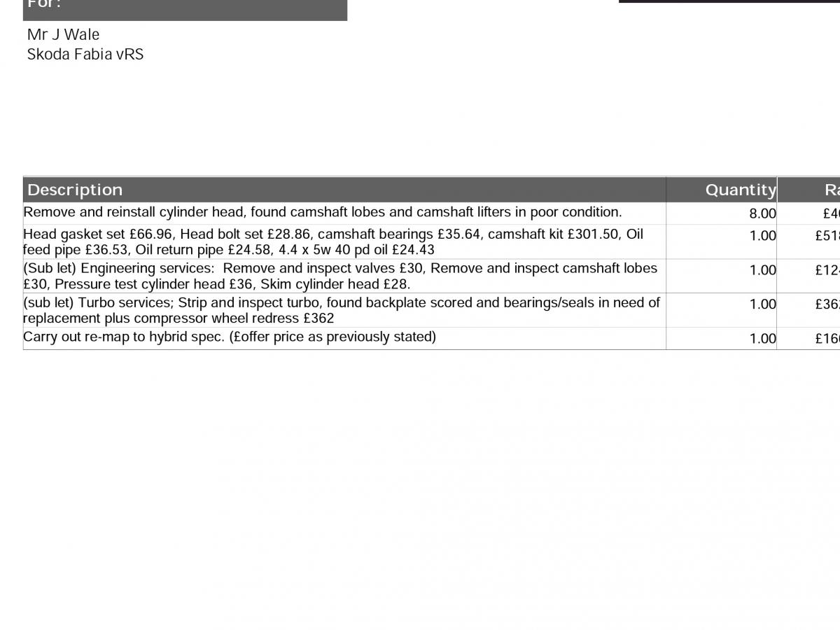

Gulp - Update time....

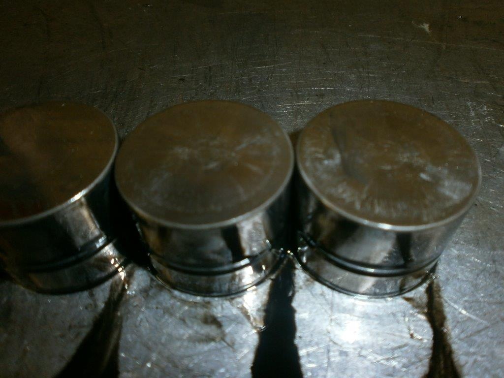

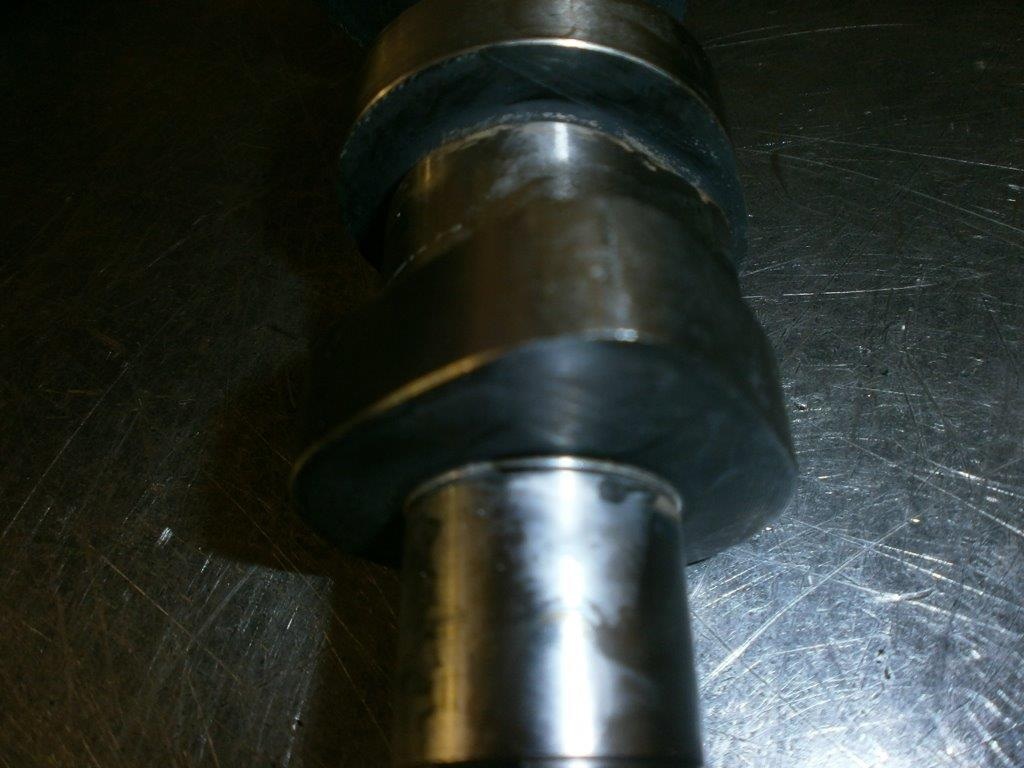

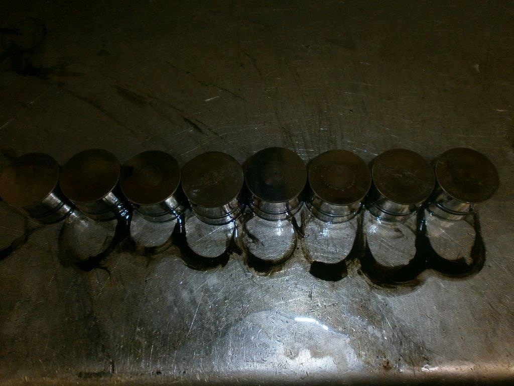

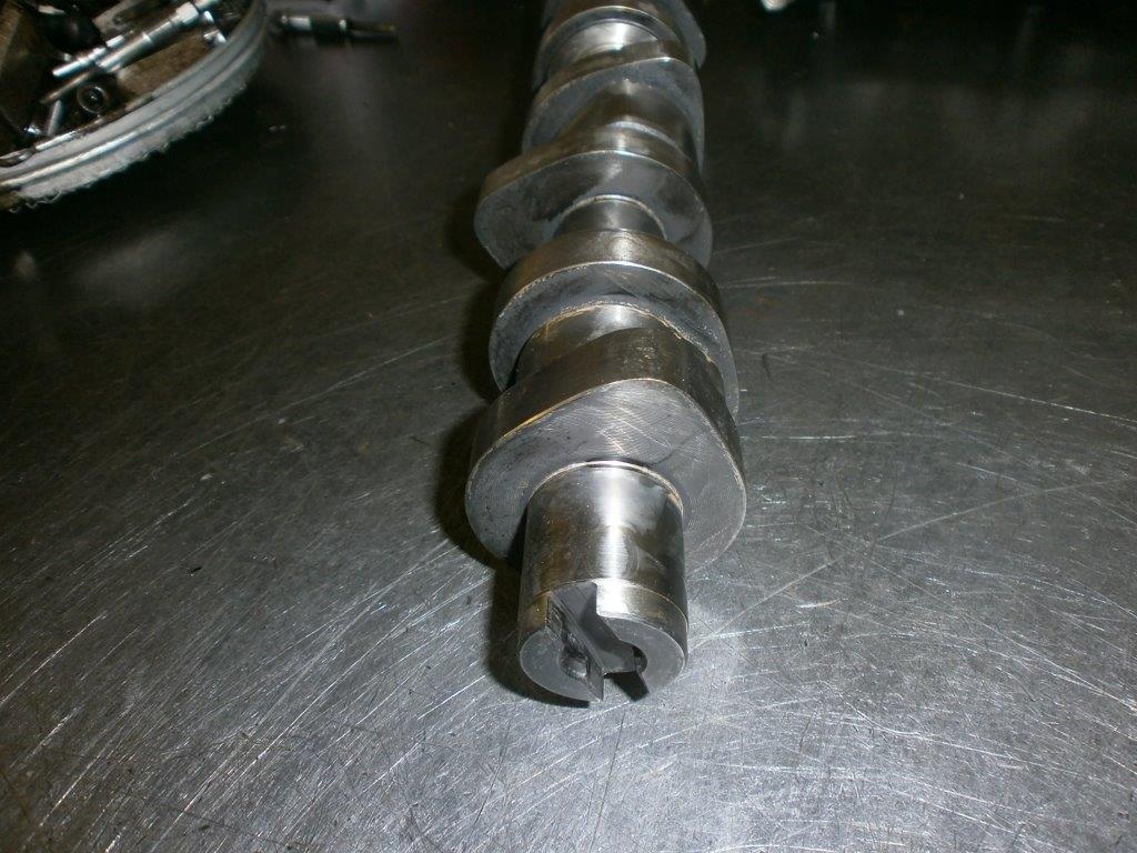

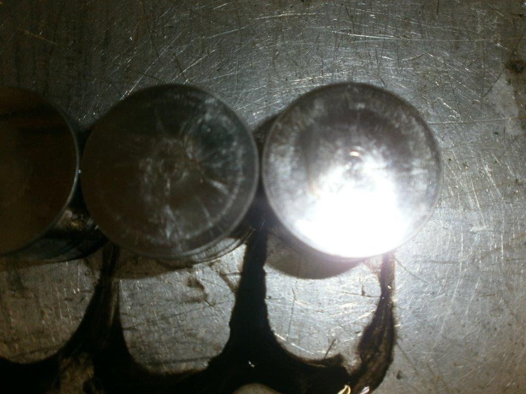

Facing a bigger bill now. Camshaft is worn out which in turn has worn out the lifters.
Are there any uprated parts I should get sourcing to replace these?

the newer oem lifters are black topped, and much better than those original silver topped ones. Replacing with oem will be the best move. :thumbup: Around a tenner per lifter from memory. Don't expect much change from £600 or so for a full cam/lifter replacement job.
It's got the replacement cam kit on there. It's all OEM sourced thankfully.
Just wasn't expecting such a huge bill when I initially took it in for a coolant leak.

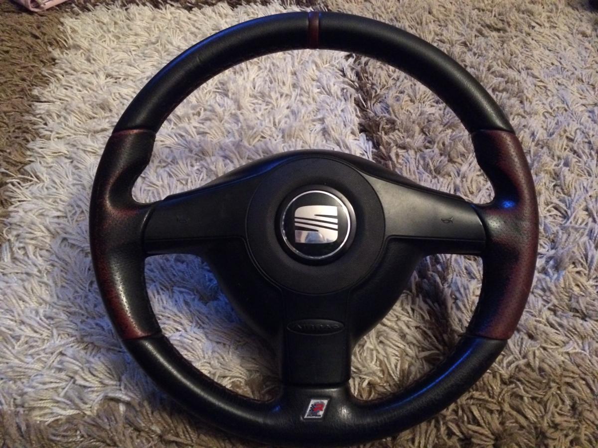

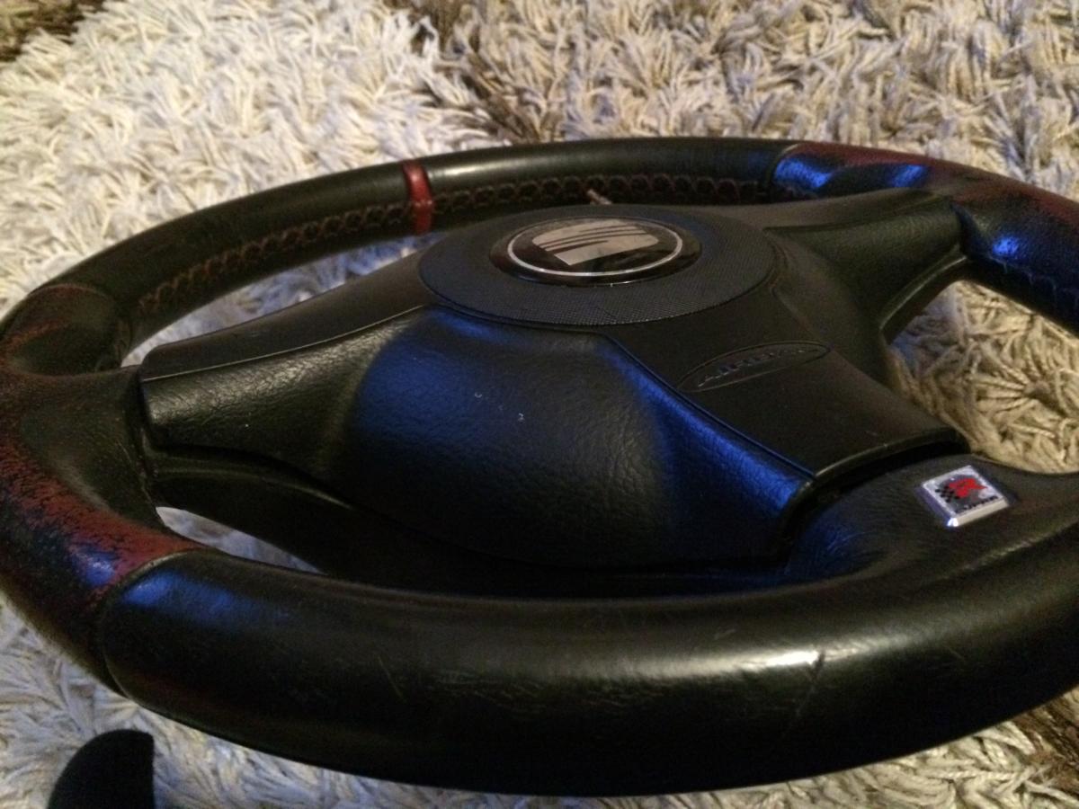

Been a while since the last update but I'm planning a retrim next month which is hopefully going to tart up my old standard seats. Picked up this little beauty from a breakers today too!
