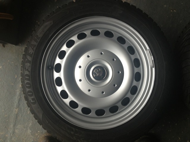

My winter wheels sprayed silver with Caddy trims (filled to get rid of Volkswagen written around the edge) then a dirty great big hole drilled in them and a Skoda wheel centre logo pushed in. Just had 3 layers of lacquer done - see how long they last. Now have to put them on the Scout.
They look great. Am leaving all as is. Cause am a lazy bugger lol
