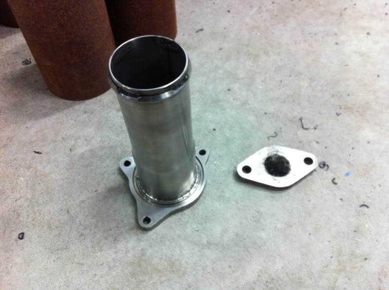

something like this (image blatantly robbed of the internet)
That's an EGR delete, I don't want that a I want to keep it OEM looking and want to keep my ASV.
