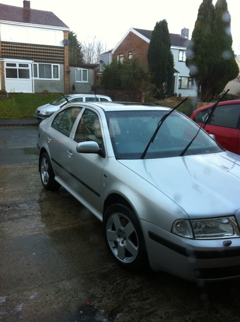

Heres a pic showing the rims that have come off today. They look good hut they handle like shiite I will get a pic tomorrow for all the haters :D it will really look like a silver taxi when I get the mud flaps off.
