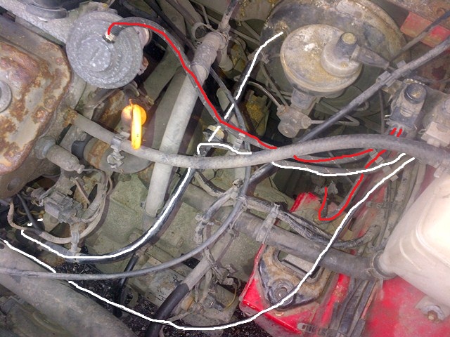

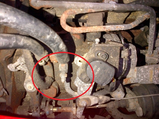

Last post above was recommendation to begin a new thread, here is pictures of the cables/tubes that i dont know where they should go,

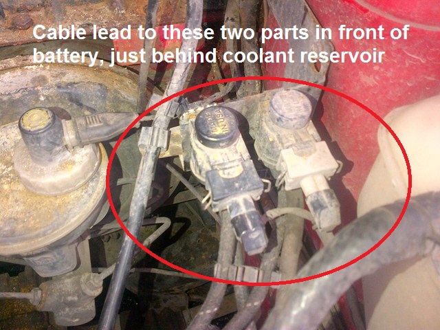

These are the parts in the engine the cable that was fixed to the injector outlet above feeds to, what do they do as i then have a cable that leads nowhere?
I have traced out the cable coming from the injector in white to the part shown above, it then feeds into another cable that runs from the back of the engine to the front. The second one beside it i have traced in red where that leads to and that has one that hangs down in the pic also not attached to anything, what are they both & where should each one lead to as the car appears to be runing perfectly?

The one with the black plug is the egr valve solenoid, basically it is a vacuum operated valve for allowing some of the exhaust gas to recirculate into the intake
The one with the brown plug is the idle boost valve solenoid, it uses a vacuum operated diaphragm to increase the idle speed under certain operating conditions...
Neither of those systems will affect the running of the engine too much

No thats fine, if they are not crucial then im not too worried, will they cause greater fuel consumption?
Not really no, the exhaust emissions will probably be a bit higher than standard, but it should still fall well witting the uk mot standards.
Having the EGR disconnected is fine.
Did it on our old Pug 306 1.9D (just a matter of unplugging the solenoid so it no longer opened, just like this one). Seemed to run better with it unplugged than before.

Hi all, returning to this topic again just as i would like to know for sure on one other item,

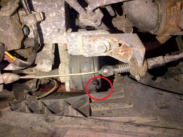

Picture of the fuel pump here shows a nozzle for a small hose to go onto,
And this one on idle cable,
What should be attached to both please?
Anyone throw some light on my last post above?
i think the nipple in the first photo is just a "bleed" nipple for when the system is first primed?!

Yeah, Tibsy is right about the nipple,. that's to help with bleeding the fuel system without too much mess. I think the other one should be connected, but that's just a hunch.
The metal nipple is for bleeding as said, the other one is the idle speed advance and should be connected to the white solenoid via a vacuum pipe, this makes the engine run smoother when its cold etc.
Thats great, thanks, so i will connected this one to the white vaccumm in first pic at top of page, cheers.
just had a look and there should be a "vacumn " tube running to white solenoid( it connect`s to the top nipple on that solenoid)i
would compressed air line tubing be sufficient?
