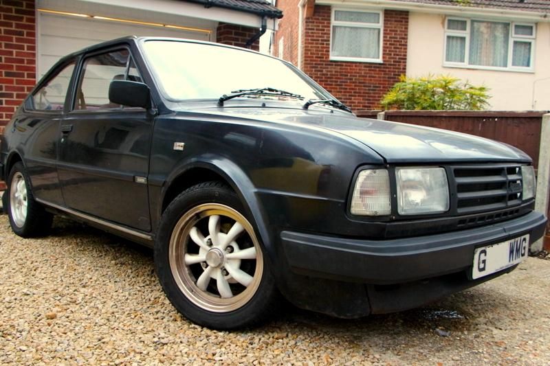

A new acquisition; going old skool with a bit more than first meets the eye. 1989 136 Rapid 5 Speed no less
Purchased this start of last month from up near Sheffield and drove it 230 odd miles home to the sunny south with no worries. Had my first rear engined Skoda when I was a student, 20 years ago, at which time this one would have been a couple of years old already. 44K miles on the clock, and was off the road for a good five years back in first half of the last decade.

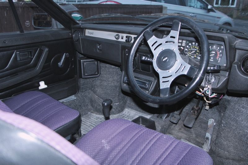

Presentable interior:

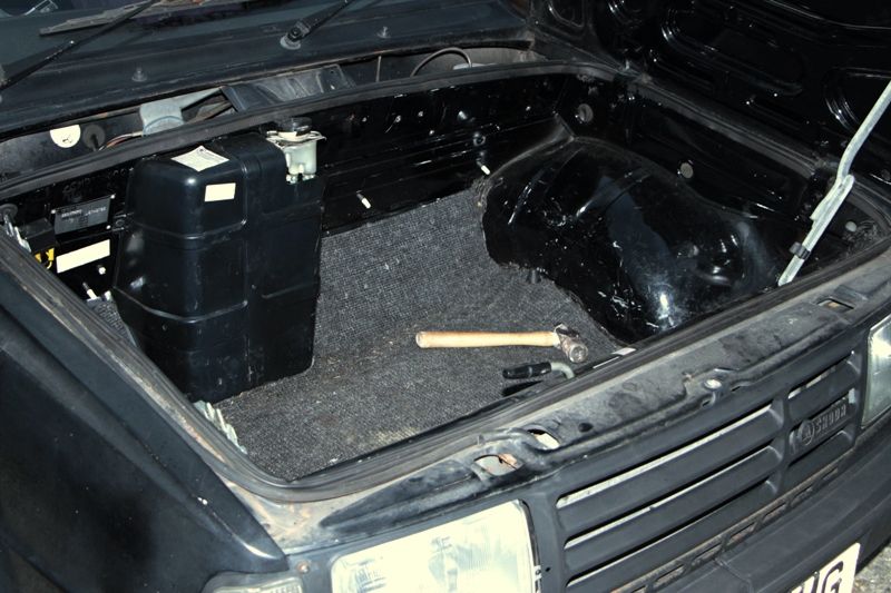

  • Continued... Shopping goes in here, though make sure its not too tall when closing the lid! So what is the twist to this one? Ermm that’s not a Skoda block… 1.6l 16 v twin cam Rover K-series b
Continued...

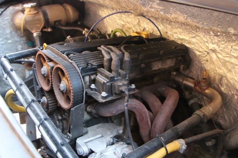

1.6l 16 v twin cam Rover K-series block on 33mm Yamaha FZS 600 bike carbs…
Very loud, very revvy, :rofl: :rofl: :rofl:
I’m well aware of K-series rep for blowing head gaskets so we’ll see how it goes. Original Skoda box and diff seem fine for now, and as you’d imagine without an engine over the front end and power steering, despite the various bits connecting the steering wheel to the road wheels being the best part of 23 years old, it is wonderfully direct and communicative!
