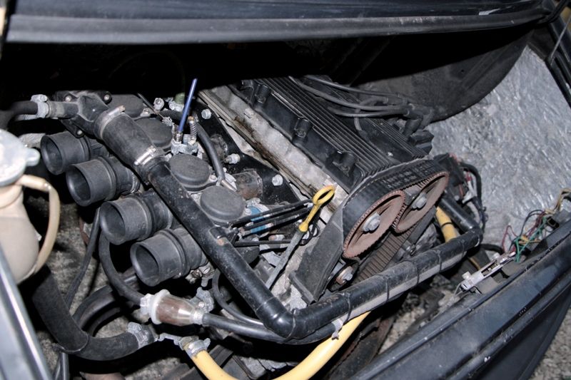

Had the spanners out this morning to start attending to the engine. So much room to work in, no skin missing off knuckles when usually removing engine ancillaries :)
There is a weeping oil leak between the cam carrier and head so I've started cleaning up the oil gunk and the block will come up nicely. (All the more reason to have head work done!)
After a bit more cleaning
And obviously with manifold removed (which literally took five minutes to remove entire exhaust once I had the scanners and socket set gathered together end), I had to see what the new shiney one will look like :)

Time for an update, so since the new year, a few hours here and there have completely wrecked things in the engine department!
Cam lobes and followers look in good order and no evidence of impending HG failure.
I have though noticed forthcoming fails for both servo vacuum take off and coolant hose to radiator, both have been rubbing on the edge of the gearbox adaptor plate.
Box of bits have been ordered and received, what this space.
So apart from stuff for the cooling system, I've got pretty much everything together to put the engine back together.
At this stage I'm not removing the head, HG seems fine for now and because K series engines have head bolts that sandwich the block together with the head and oil ladder in the sump, the engine would need to come out to extract the head bolts at the back of the engine.
Cam carrier does need re seating with new sealant so I am changing the cams.

Time for an April update on progress as of late:
Decided that block will look better painted, so base coat on
Top coat is a pale grey, but looks white here, gold cam cover too:
Linuished cam follows (inlet side done here) ready for new cams
Which brings me on to a problem. Previous to this photo I had bolted down the cam carrier with the seals in place because with the engine in situ, I can't press the seals in at the rear because of the bulkhead. Consequently one of them partially popped out and wouldn't seat into position , so no other thing for it but to remove the cam carrier again. Still, it gave me the opportunity to check that the amount of hylomar gasket applied was not excessive for blocking oil ways. Back to the cam seal, I think I will try again (with new seals) but keep a careful feel of their position as I bolt down the cam carrier. If they leak at the end of the day, I guess engine will have to come away from the bulkhead in order to press them in.
Meanwhile, starting to work on the plumbing, so lots of bits of blue silicone hose sections acquired. Here is the radiator return to the new water pump.
I'm fitting temp sensors on the outlet and return side of the cooling system to enable accurate monitoring of cooling status, not least because of k series engine dislike of too much heat. So will have one of these on the dash:
http://www.spa-uk.co.uk/Product/TemperatureTemperature%20Gauge%20(DG210)
I am also considering fitting a Craig Davis 80l/min electric water pump and controller up at the radiator; there is a lot of pipe work for what looks a fairly weedy water pump to push water up and down the length of the car, particularly at idle engine speeds. Once done, cooling system should be bullet proof (assuming HG is in good order).
Meanwhile, carbs have new float chamber gaskets, and new linkage cable.
Finally for today's update, a new sump has been obtained and now modified and painted. Because the engine is mounted vertically in this application, the sump retained about a litre of gunk when the sump plug was removed. So a repositioned drain point has been welded up and the original plugged. All painted and ready to go back on. (One bolt on the bearing ladder sheared on removal so needed drilling and tapping.
New plug inset into sump:
Original position plugged with a screw in bolt
And painted
This week's update.
New cam seal this time seated correctly, checked with the aid of the front camera on the phone: far better than struggling with a mirror. So happy this time
With cam carrier on, next on with new cam cover gasket
And then finally bolt down cam cover
Next to installing new cam belt, sooo easy with so much space around the engine
Close up of belt train, leaving covers off for show, car will do limited mileage and being out back, less likely to flick up stones to get caught in pulleys
Unfortunately I've misplaced my 22mm socket so still need to remember to torque up crank pulley bolt, must not forget! Meanwhile, wrench on crank turns the engine over smoothly and no crunch at TDC + 90, so not messed up the timing!

Cooling system is next on the agenda. I've sourced an original outlet flange for the engine and have had this modified ( thanks to Dad ). Original had two screw in senders, plus outlet for top hose and heater. Now accepts original skoda temp sender, heater outlet points directly at bulkhead so has a blanking cap, and the second sender port has been bored out and a brass fitting turned to act as feed for heater. 32mm top hose outlet will go to thermostat and off to front of car.
Need to source a job lot of hose clips and joiners, then can move on to refitting carbs and re-route the fuel line and complete other bits and bobs including tidying up wiring etc.

It lives! Last couple of weekends have been spent replacing the engine bay insulation and working out the plumbing layout.
So from this at the turn of the year
To this:
Still need to wire up temp senders I've added to the water outlet and inlet hoses and have a electric water pump still to fit up at the front end. Then there are air filters to think about and tidy up the wiring.
Bit of a moment this morning though, despite plenty of cranking could I get it to fire? Main issue is that I had lost my diagram of HT leads to which coil pack. The coil pack did have faint numbers (not written on by me) so I tried that firing order but clearly wrong. So after careful studies of various photos of the engine bay before I stripped it, I had another go. Started pretty much first off but with major mis fire. Swapped cylinders two and four around and perfect. Took it for a drive around the block and ran nicely :D.
