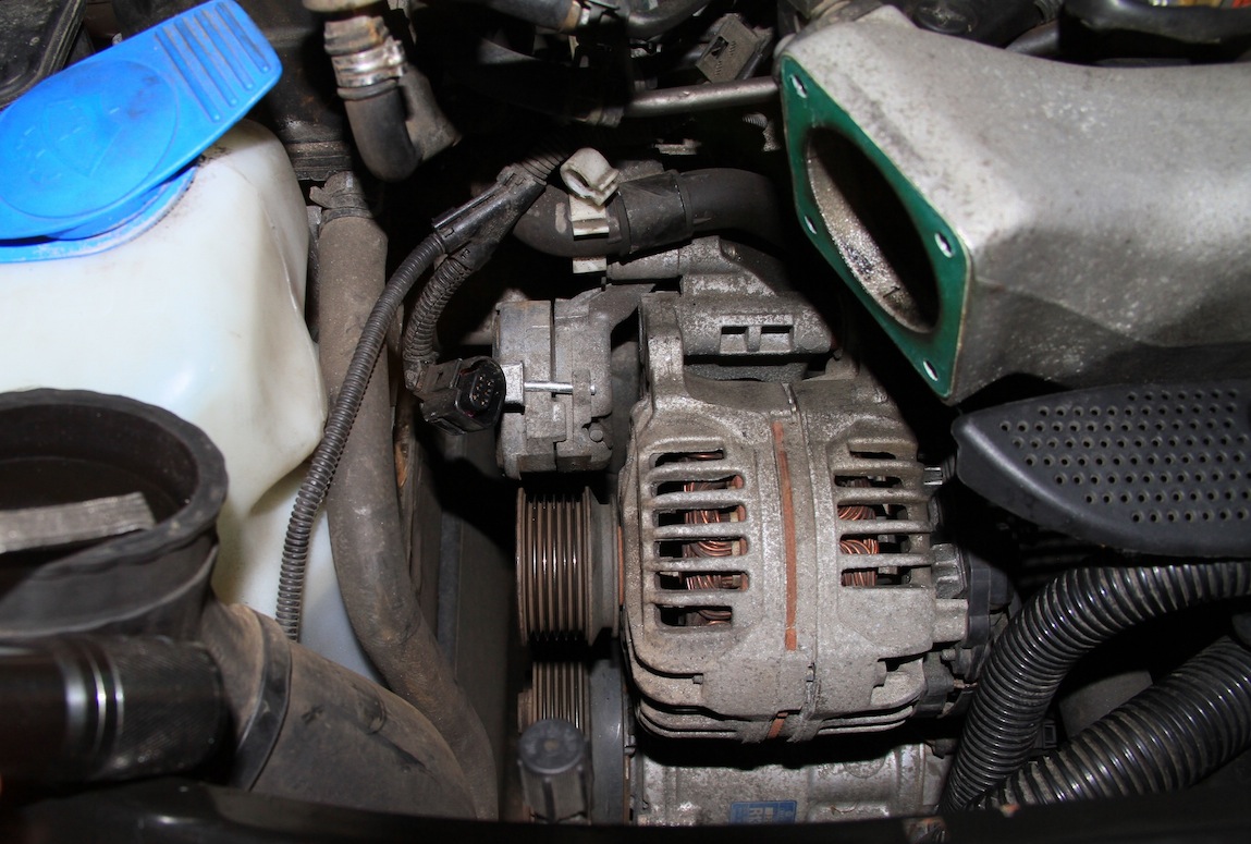

Well this is turning into a real pig of a job. After nearly an hour, I've found and prised apart all the connectors with their finger-killing clips, removing the battery box in the process. The one thing that I'm stuck on now is the final clip that holds the cable to the alternator - not the electrical connection, but something else that bends the cable into a U-shape. I can't see it and I can't feel a way in. Any pointers?
It might be the thing near the bottom-centre of this picture. Still can't see how to undo it, though.
That thing at the bottom of the picture would just be held on with a bolt/nut I would have though. I removed my alternator a year or two back, but I can't remember there being anything too complicated about it though, so that doesn't really help.

Maybe a bit late now, but here is a picture of my slightly larger alternator (from my diesel). From that it would suggest you should have been looking for a nut to remove.
A belated thanks for the picture.

When the alternator spins, should the coils of wire that are visible through the ventilation holes move or are they static?
IIRC when I took the alternator out I had to remove the power steering pump on my TDi in order to get a one of the bolts holding the alternator on. In order to get the pump off you need to get at the bolts which hold the pump on which are behind the pulley which drives the pump, so BEFORE YOU REMOVE the aux belt you have to loosen the bolts on the power steering pulley. Then take the belt off, remove the pulley from the pump and undo the pump mounting bolts.
I think that I loosened off the alternator and then I could get at the lower nut which holds the cables to the alternator, the I took the alternator out of the car. I think I also removed the fans from the radiator to make a bit more room.
If the petrol engine is like the diesel the alternator has to out of the top of the engine, the bracket which holds both the alternator and aircon compressor stops you taking it out the bottom.
As for the output of the alternator, it should say on it, on a sticker on the side. Failing that ring a dealer / TPS with the part number (which is on the end and visible in your photo) and ask them
On my way out to the car now to measure voltages to begin with.
I think they should move, there should also be a fan thingy visible (towards the pulley end which should obviously rotate).

I've removed the two large (13mm) bolts holding the alternator on (note to others - you'll need to use a spanner on the top one as there isn't space for a socket) but the damned thing will not budge. It feels like it's still bolted on (firmly!) but I think it's just seized to the bracket. Any tips, other than just "hit it with a hammer!"?
In mine, the coils don't move but I can see the fan blade inside them moving. It doesn't feel like anything's obviously broken.
I've taken the opportunity to clean the throttle body but still can't get the alternator off!
Here are some pictures showing how removing the throttle body improves access, and how to use a (shortened) 5mm drill bit to hold the tensioner out of the way.
Now, why won't my alternator budge?
Put a pry bar / big screwdriver / crow bar between the alternator and the mounting bracket and carefully encourage it out.
There are sort of floating bushes (don't know what the technical term is) which are pulled out against the mounting bracket when it is tightened up, when you remove the bolts the bushes don't move and thus keep it held in place.
I used a big G clamp to push them back in before I re-fitted the alternator.
