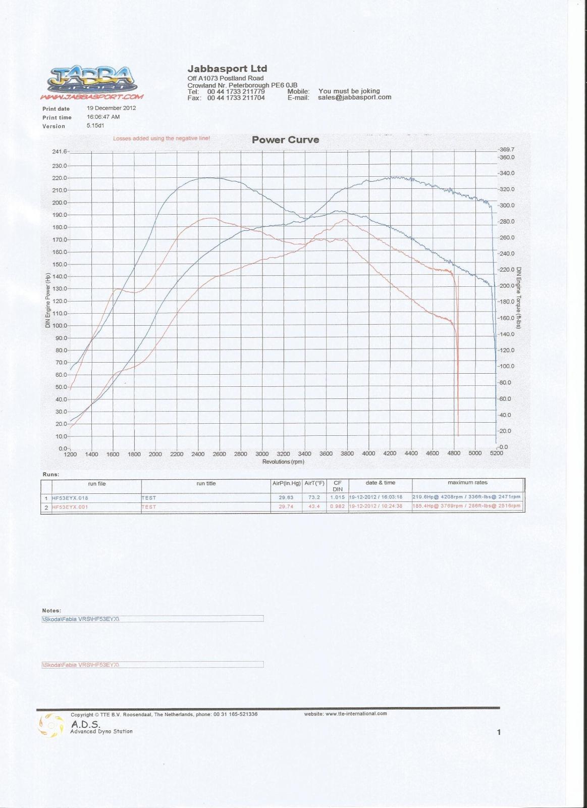

Went to Jabbasport to finally re-re-map by car after having made lots of changes to it since they last did it. Slightly bigger turbo (MD376 v MD374), bigger FMIC (THS seat sport style v Forge FMIC), decat, jetex exhaust and Jabbasport cone in a box.
Results are on graph below.
When run first thing, it produced 185bhp and 286lbs/ft (red lines) - showing that the original custom map was not suited to the new hardware at all. Power dropped off badly after its peak at 3769rpm.
Once Kevin had worked this magic, and after several power runs during the day, we got 220bhp and 336lbs/ft (blue lines). However that doesn't tell the whole story. Power does not tail off so sharply, producing 200bhp all the way to the red line.
Bit disappointed with max torque figure - not sure why its so low. I think it's lower than when it had the MD374, but I need to dig out the previous graph from Jabba supplied by previous owner, to double check.
But it's so nice to drive now and very rapid.
Excellent results :-) I bet it shifts now!

it certainly does now!

Cool. I really wouldn't be too disappointed with the torque level you have in that case.
