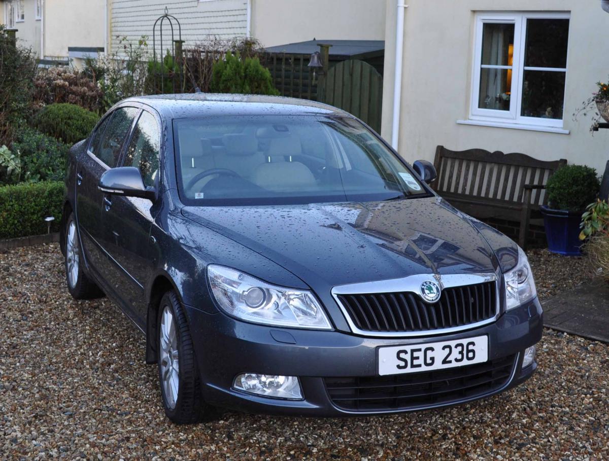

If following the procedure outlined in the manual doesn't work (you have Maxidot so the DRL function should appear in the lighting menu) then you need to visit a dealer for them to first activate the function. Once activated the ability for you to turn them on and off becomes available.

Carnut -- at 2009 your car is on the changeover age and you haven't told us which side of that changeover it is -- it could either be a late preFL or an early FL. As said, if it's an early FL you can do it through maxidot, if its a preFL you need to have it programmed with VCDS.
Silver's picture is for the FL. Only the FL models have the extra dedicated DRL bulb in the fog light unit.
