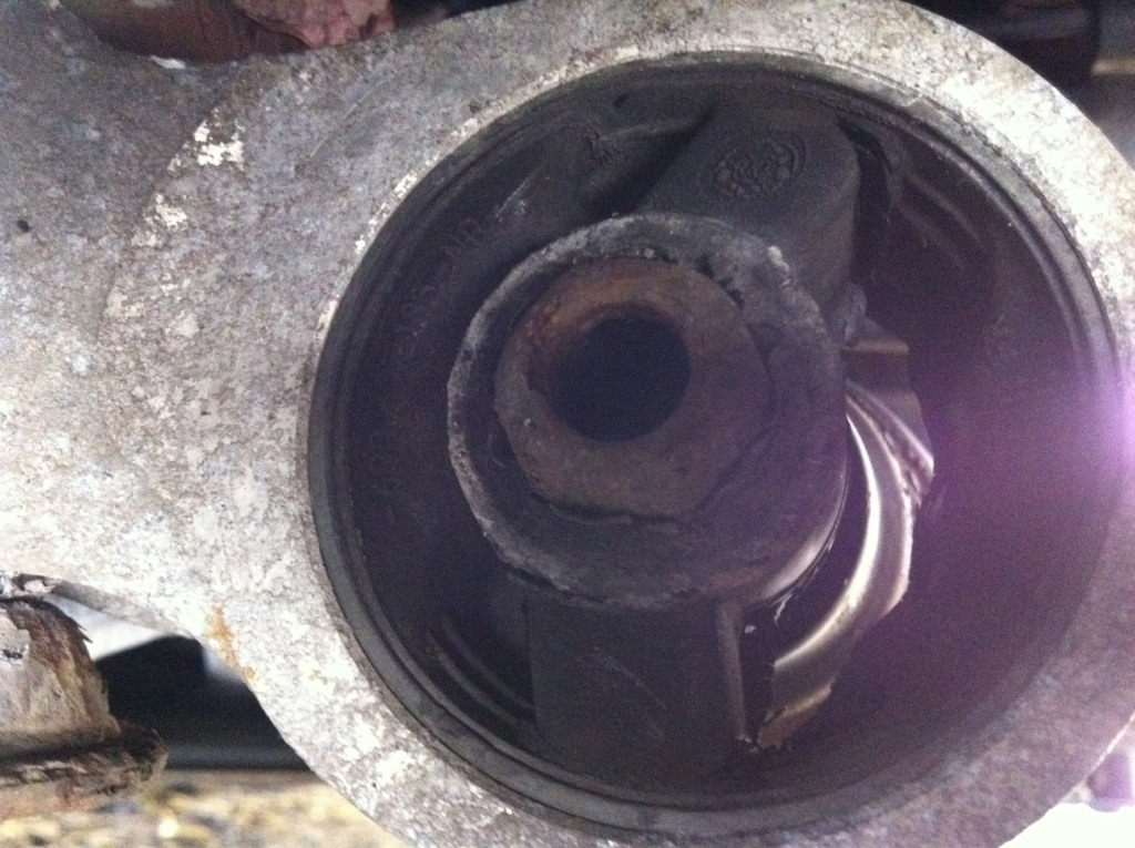

Drop links and console bushes are the first thing to check. A knocking over rough ground from the front when going in a straight line is classic drop links, if you can change a wheel you can change drop links, they're also inexpensive.
Console bushes are easy to spot, put the wheels on full lock to the p/s then have a look at the d/s rear console bush. If yours looks like the pic below then order a set of Powerflex bushes if you're fitting them yourself or Cupra bushes if you are getting them done by someone else. The tears top and bottom cause the rear of the wishbone to bang against the inner face of the console.
mine has just passed an mot, console bushes are fine no rips tears etc.. drop links are fine no play what so ever. ball joints etc solid. only thing left is strut top mounts
