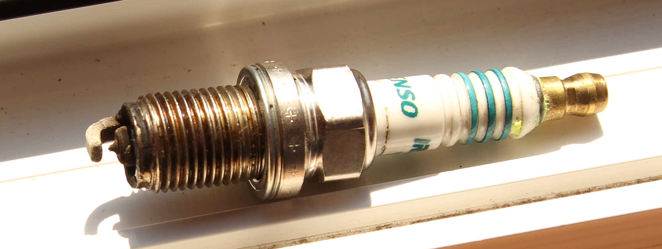

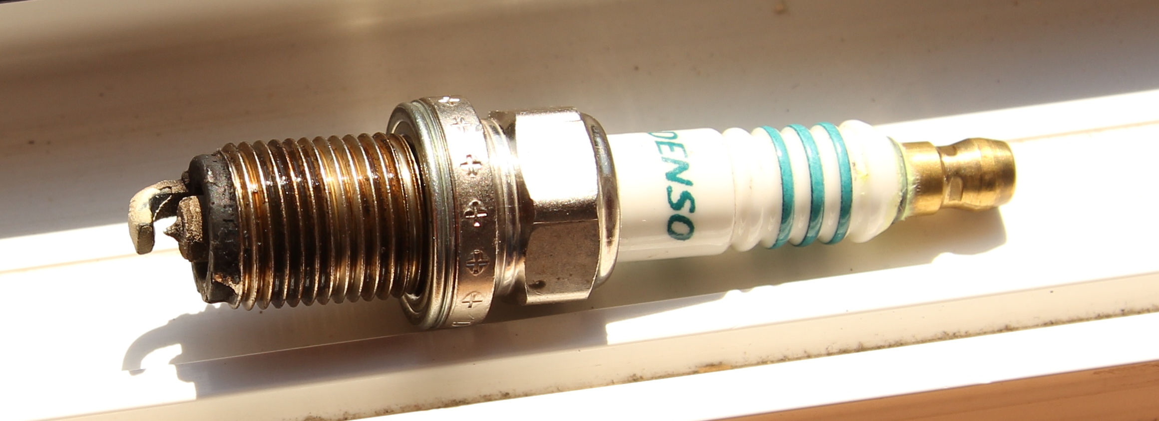

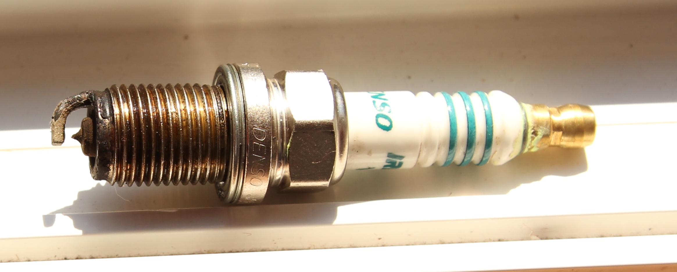

Do you have more pictures? Especially of the spark plugs? And of the carbon build-up? More pictures is always interesting.

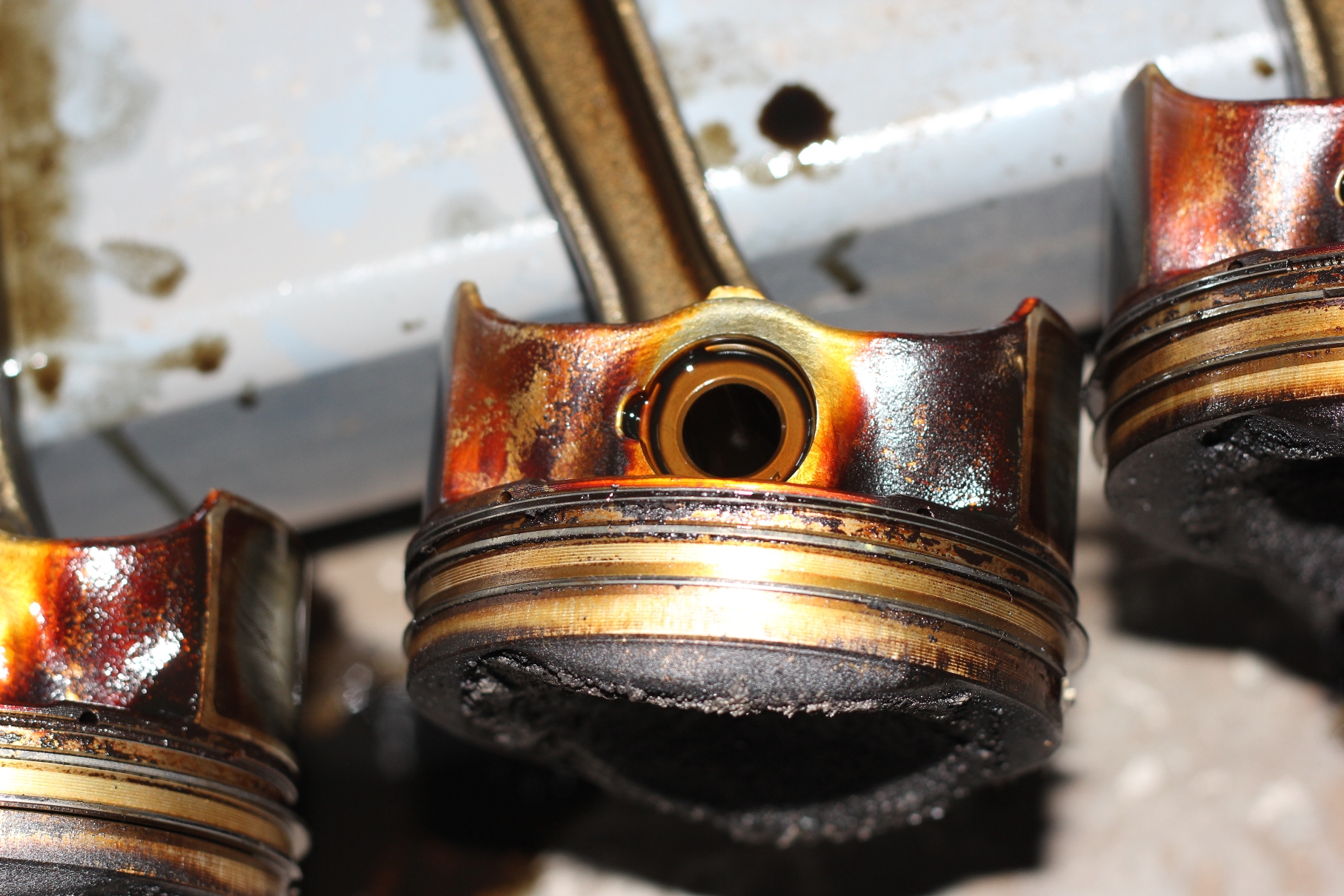

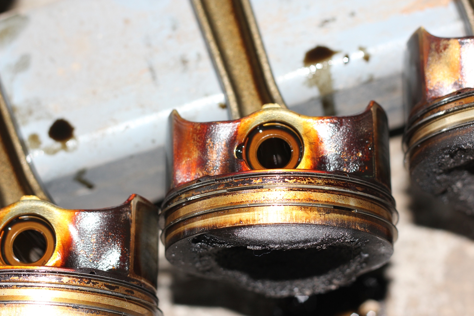

Hi All,
Finally I repaired my Superb 1.8 tsi in a independent garage ,  paid around €1400.  The pistons were not  worn , only the rings were totally scrap (like a mild steel, wasn't  rigid at all)) so beside the ring set replacement the following parts were also exchanged:

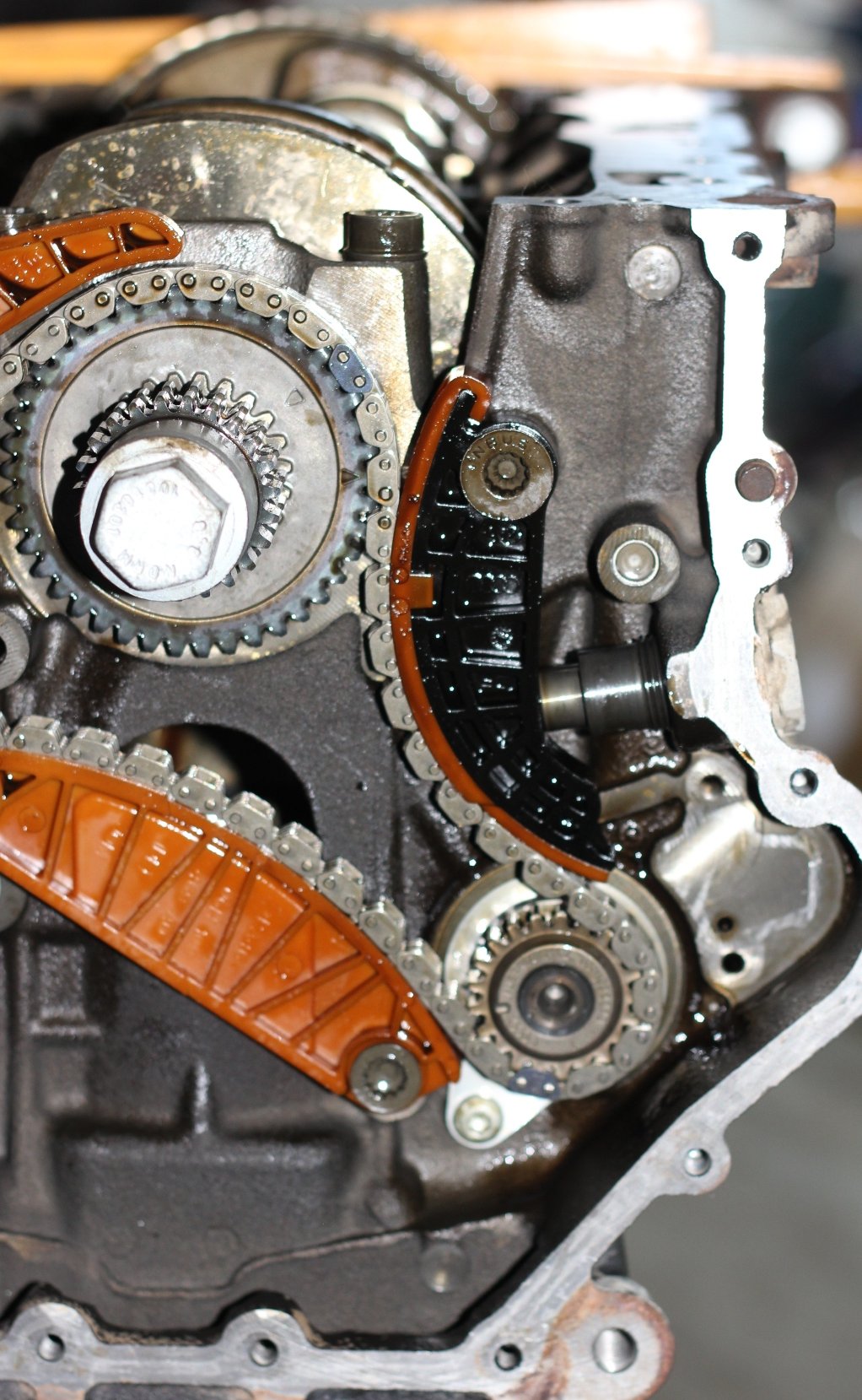

So obviously the rings were the main cause of the oil consumption problem (factory under designed) but also the chains are modified since 2012 (improved).
Camshaft has NOT been replaced although a sign of deterioration (wearing)  is visible. It would cost additional €650.

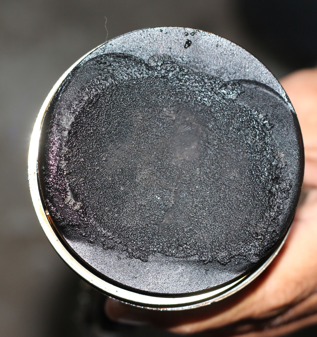

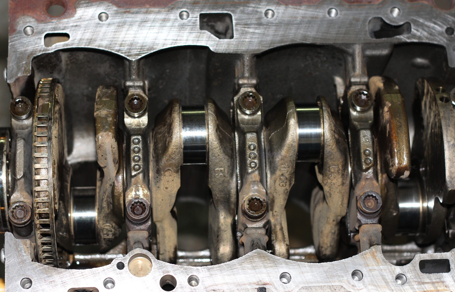

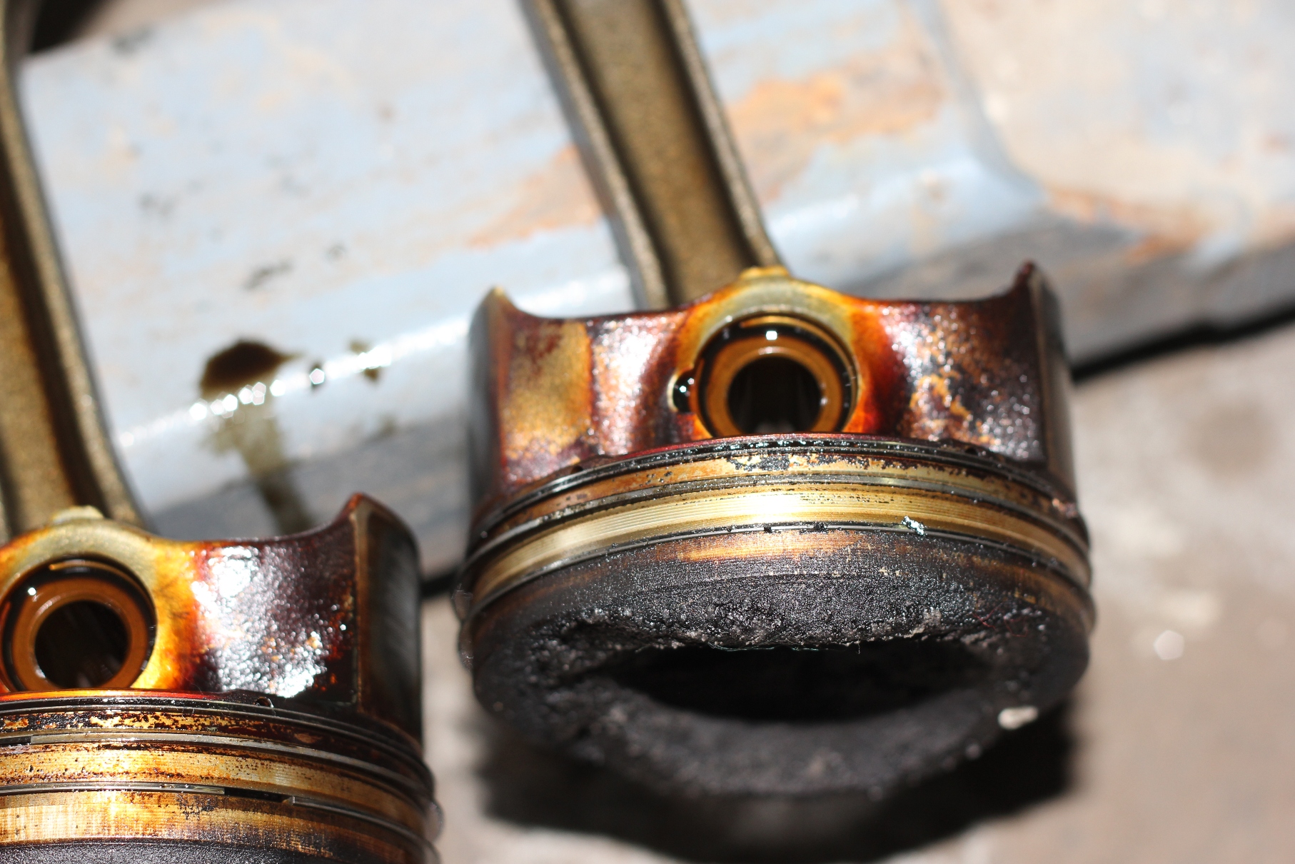

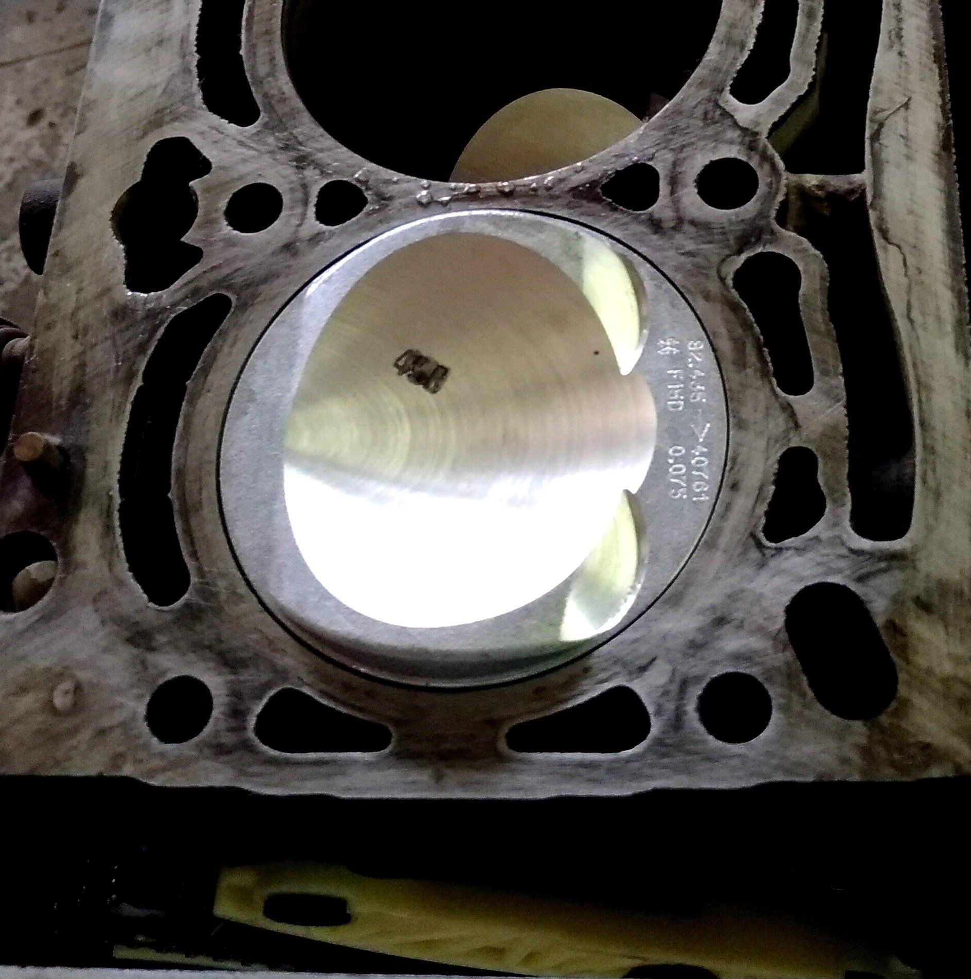

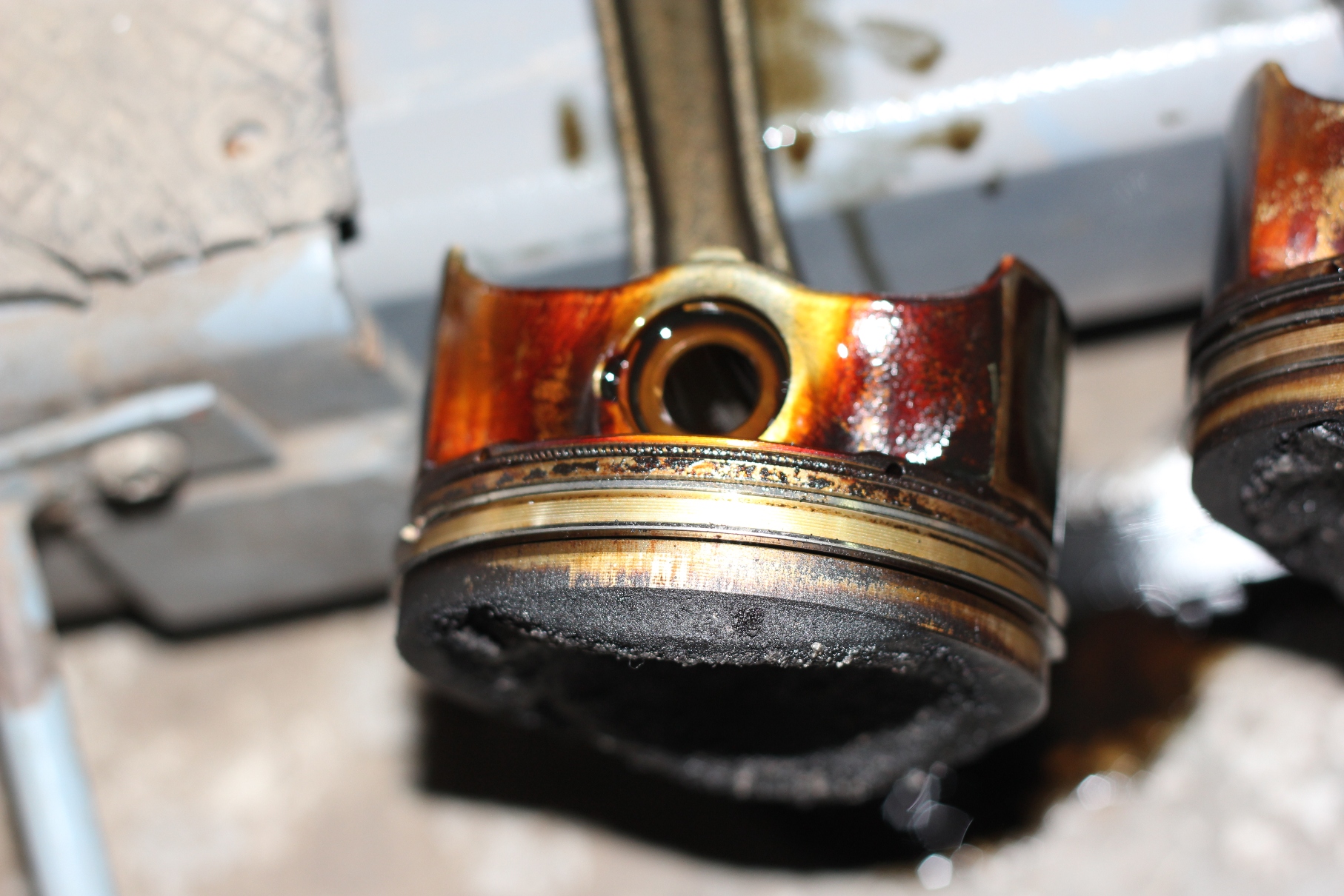

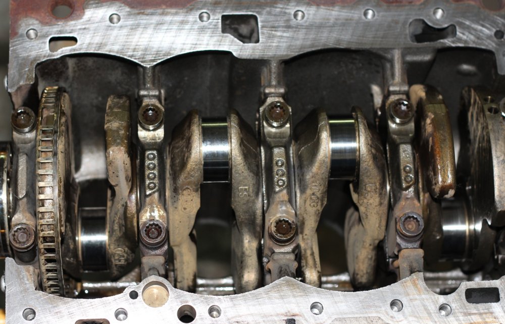

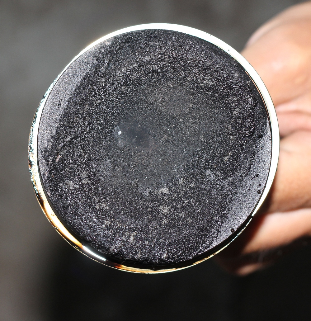

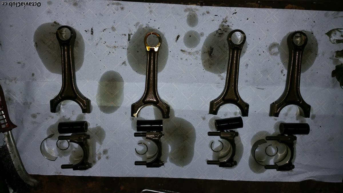

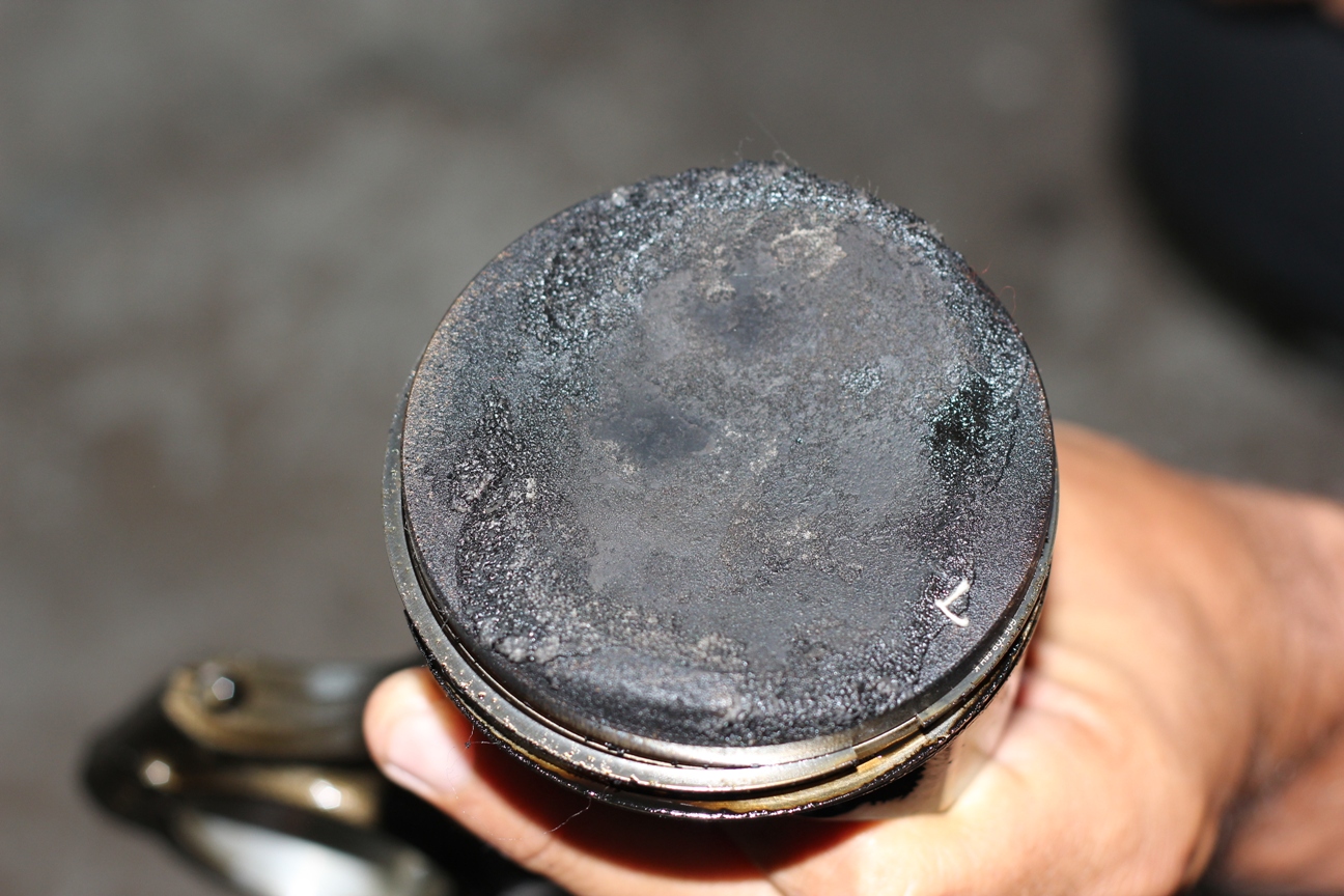

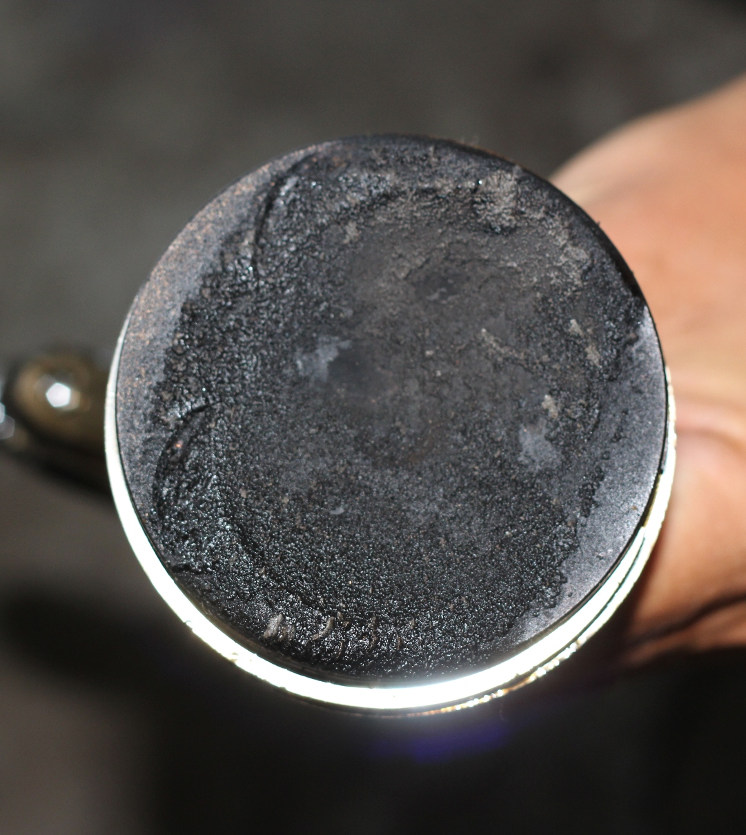

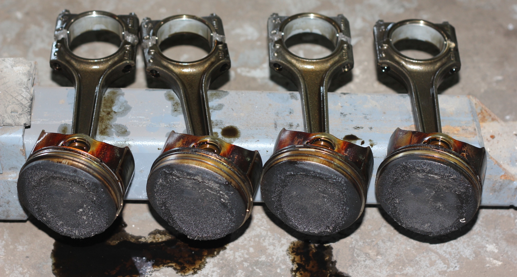

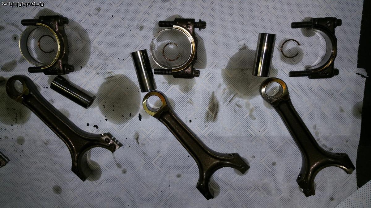

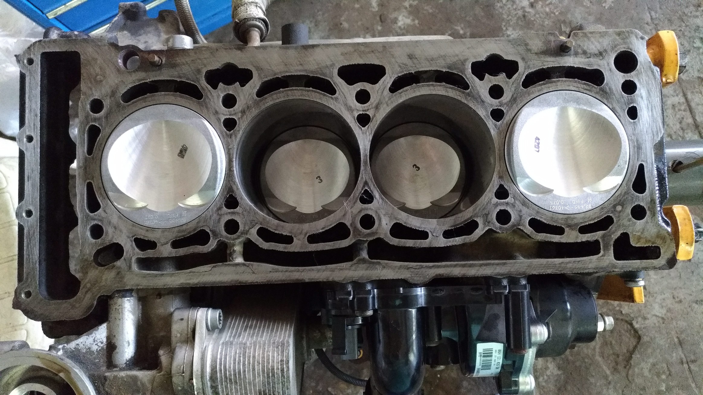

CDAA repair - day 2 cylinder head and pistons were removed and their condition is shown in the attached pictures.  Chain tensioner look good but will be replaced along with chains.

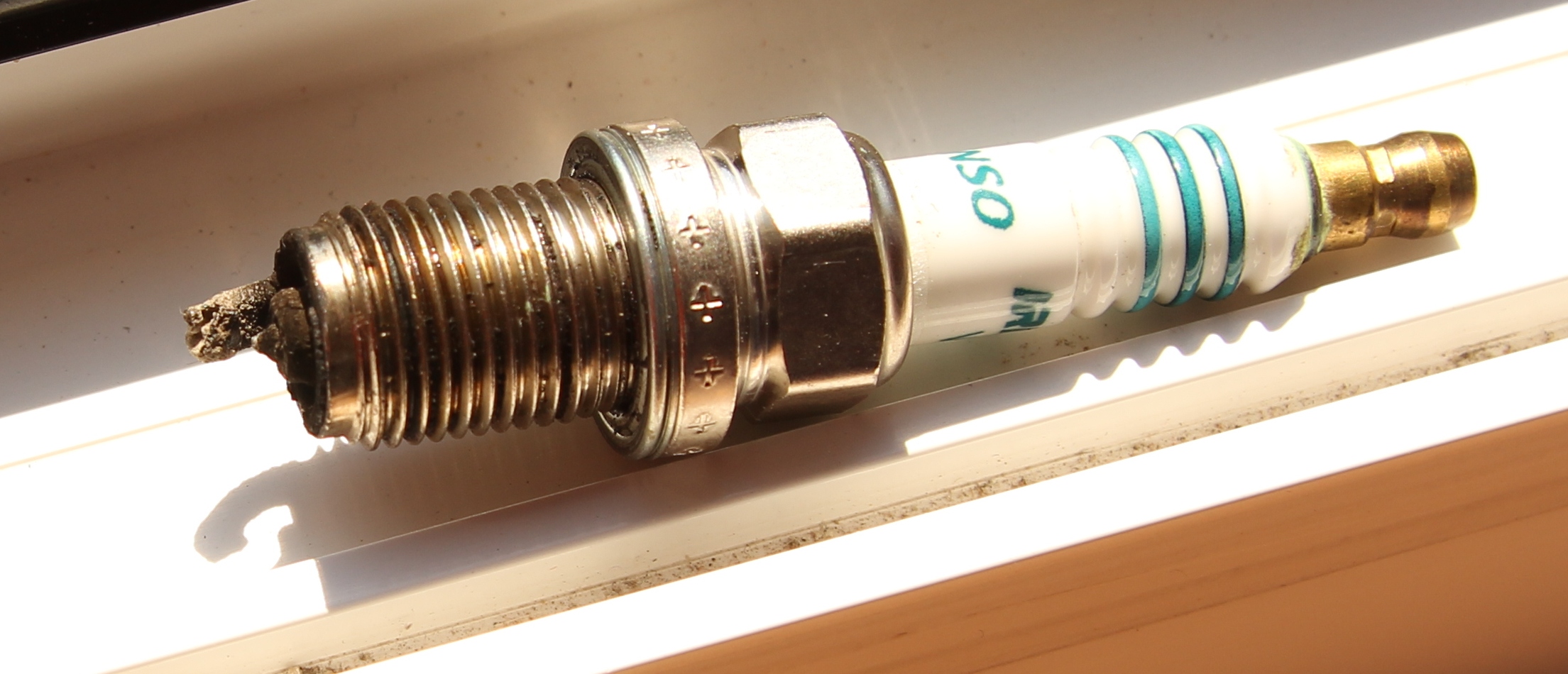

18 hours ago, andrehj said:
Hi @safari hunter. Thanks for your report and apologies.
Spark plug it is

Well, would not call it OEM but Aftermarket, but it can work though. Would be interesting to know how it works after drive in period in longterm use.
My personal view on this. As GDI/TFSI/TSI etc. engines run often homogenous lean with 1 < Λ < 2 or even leaner in other modes, the NOx are the issue. Yes, two basic options are how to fight against it. First, the NOx trap/accumulating catalytic converters. But those are expensive ... So second, much cheaper option is EGR ... In case of EA888 its internal version done by the  use of continuous cam phasing ...
But use of EGR leads to production of solid particles (particulate matter PM), that means not only for engine oil excessive load. In case of EA888 those tiny drainage openings at miniature oil control rings can not cope long and get clogged, especially on LongLife service intervals ... Internal EGR bring us yet as "bonus" the dirt on inlet valves. I believe the direct injection technology on petrol engines is step back, currently introduced petrol particle filters (PPF/GPF etc.) just confirms that PM are big issue not just for diesels ... GDI/TSI gate likely soon???

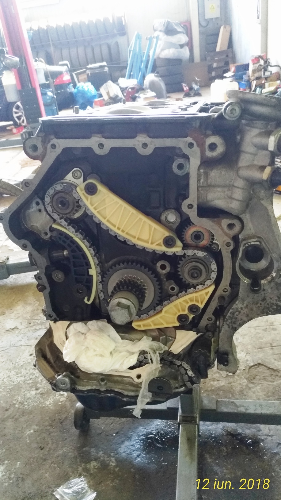

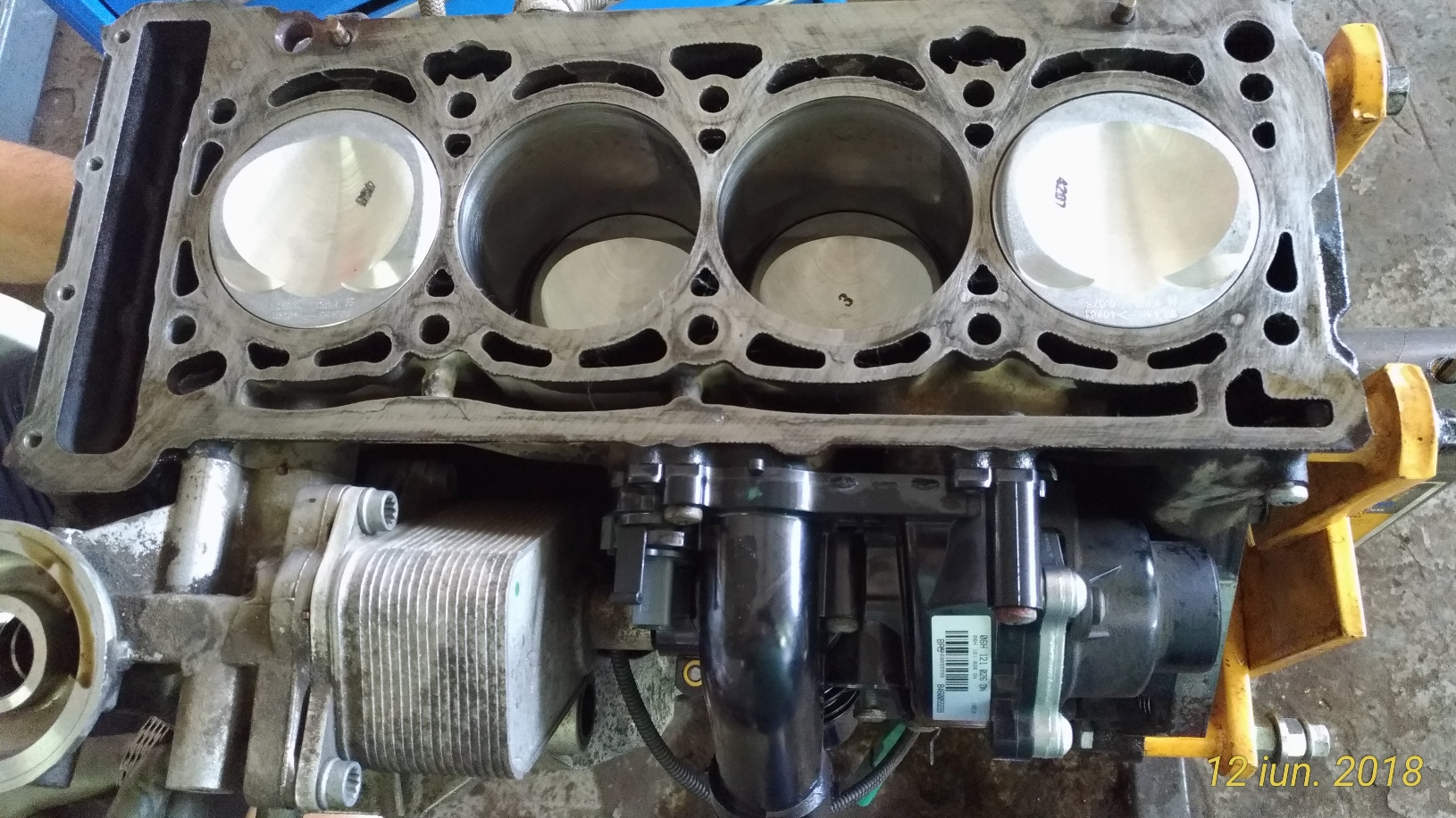

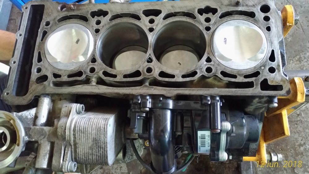

Day 3 : cylinder head was completely inspected and cleaned and installed on engine block. Only valve seals were replaced.
What a confusion from your part list ... :biggrin: You wrote nothing about new con rods, and only mention 4x set piston rings (OEM).

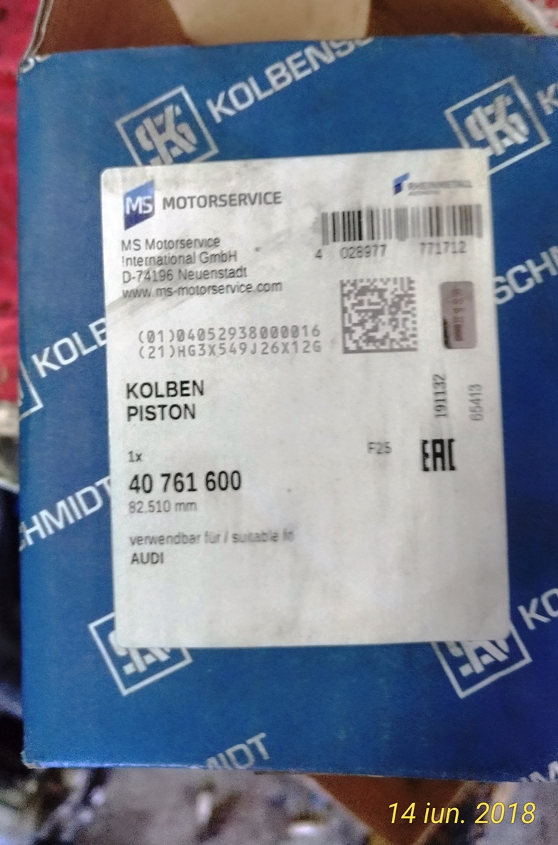

From photos I see you got new KolbenSchmidt pistons 40 761 600 (EAN 4028977771712) which are already for 23mm pins, already assembled with piston rings, unfortunately with the bad version of oil control ring, only drilled one again, prone to clogge ...
Your engine is what MY and month? I guess it is before end of May 2011, so you got 21mm piston pins. In this case is better to use piston sets 40 251 600 (EAN 4028977685996), version of 06H107065BK from BZB engine, no reason to buy new con rods too.
https://www.briskoda.net/forums/topic/266114-18tsi-and-20tsi-engine-failures/?do=findComment&comment=5017852
If it is later one, that means it is another proof of VAG genius, as these beasts were equiped with oil control rings of 2mm height, but still only drilled, not slotted as on trouble free pistons 06H107065BK from BZB engine or Three Piece Flex Vent known as SLF/Miniflex/multi-piece from latest piston version ... From June 2011 till about October 2011 VAG used pistons 06H107065CP, then till about 2015/2016 pistons 06H107065DF. As these are problematic too, last version 06H107065DL with SLF oil control ring was introduced.
In this case I would recommed to use from KolbenSchmidt their version 41 197 600 (EAN 4028977886003) with SLF oil rings instead of used 40 761 600.

Yet concerning the timing chains and parts, only VAG/ OEM Morse parts used or not? Many aftermarket parts on market, FAI, ET-Engineteam and others, those are very questionable ...

According following info pistons 40 761 600 should be fitted with slotted oil control rings, so be sure you check it before engine assembly.
http://vwts.ru/forum/index.php?showtopic=192986&view=findpost&p=2807259

The only thing what confuses me now is the pistons at safari hunter´s engine does not seem to have black coated pins, which are on 23mm versions without bushings, I see it more as silver ones used on 21mm versions with bushings. Could you please measure the height of oil control rings on old pistons together with diameter of pin? Thanks ;)
Just as info, 21mm vs 23mm
21mm
23mm
Edited by rayx

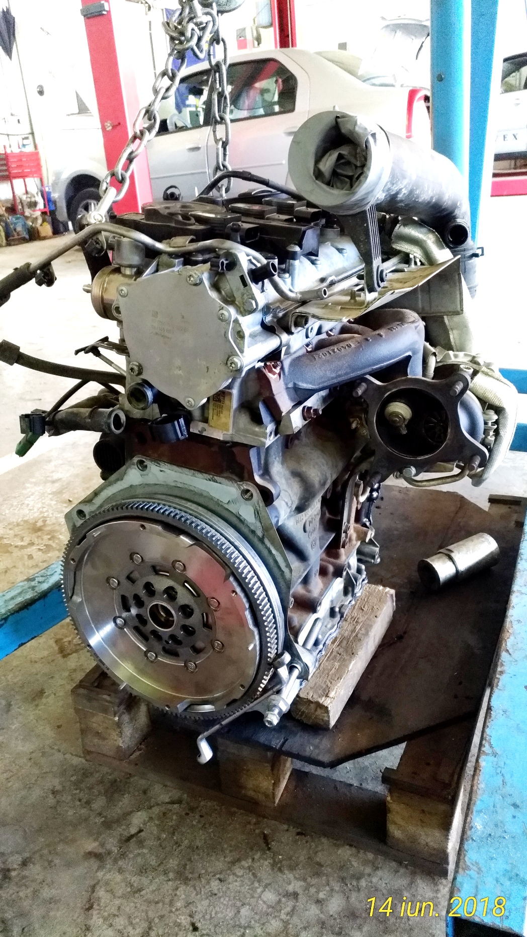

Rayx @ yes these were the pistons installed as the picture confirm it. Engine is now complete reassembled and will take 2-3 more days to have the car back.
Overall repair cost with new water pump, new clutch assembly and engine parts up 3500E.
Well, hope you got the pistons with slotted oil control ring and not any old stock ;)
Concerning con rods, what was wrong with old ones that you needed set 06J198401H of new ones?
Old fashioned pistons diameter was 21 mm , new pistons come with 23 mm con rods.

Hi Dave TO @ after discussing with CDAA owners that went to horrifying process (the repair) there are some common features that will trigger the engine failure:
(1) oil consumption over the recommended limit (500 ml / 1000 Km). To me it accelerated from 500 ml to 800 ml in less than 10K km. Previously I tried as you can read on my posts to change oil quality, add additives to increase oil viscosity but none of that helped significantly. You can use a bore-scope  to inspect the combustion chamber for excessive slag deposits as you can see in my pictures. Also you can observe abnormal cylinder wear .
(2) engine hesitation can be induced also by the condition of spark plugs when clogged with oil ashes or in my case with melted electrodes due to excessive temperature generated by hydrocarbons presence (gasoline and large amount of oil remaining in the chamber due to faulty oil ring (see piston 1 picture for oil ring condition compared with 2/3/4).
