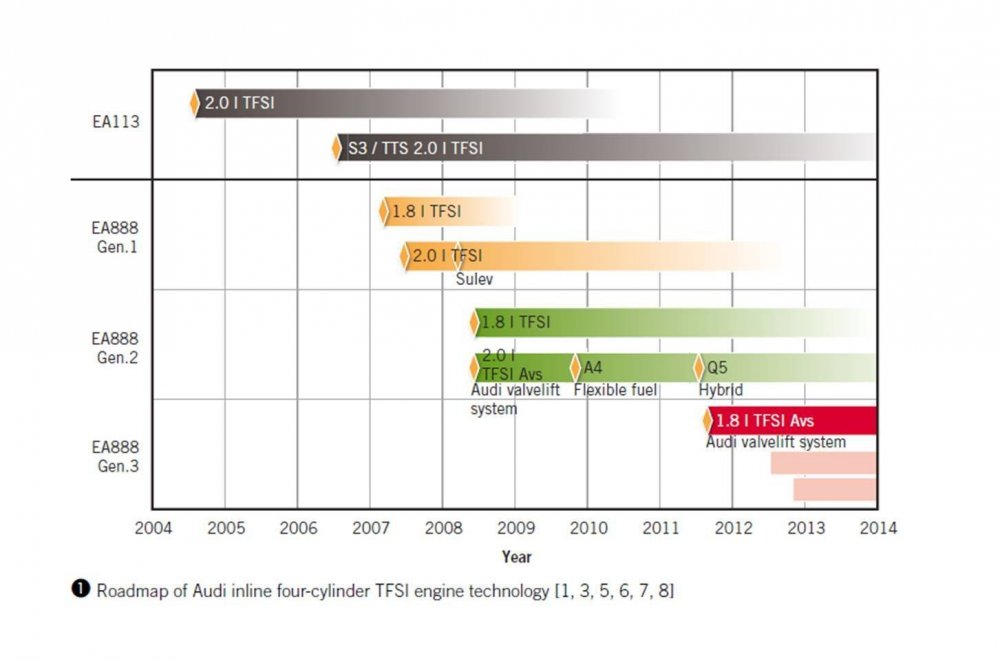

    Looking back over my shoulder I could see what I said wrong and what was right about 1.8 TSFi excessive oil consumption. First of all ADREHJ and RAYX pls have my apologies for contradictory opini

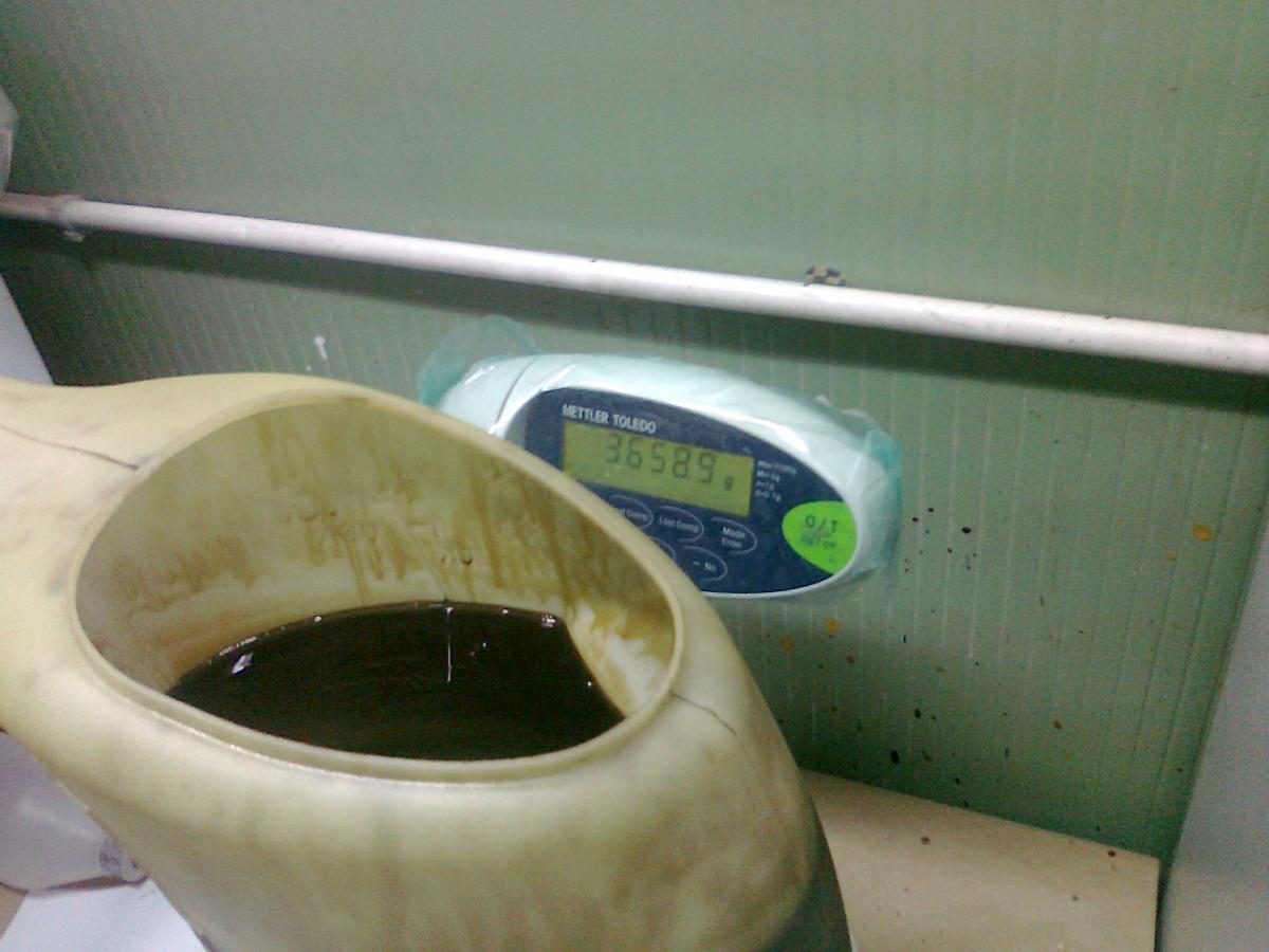

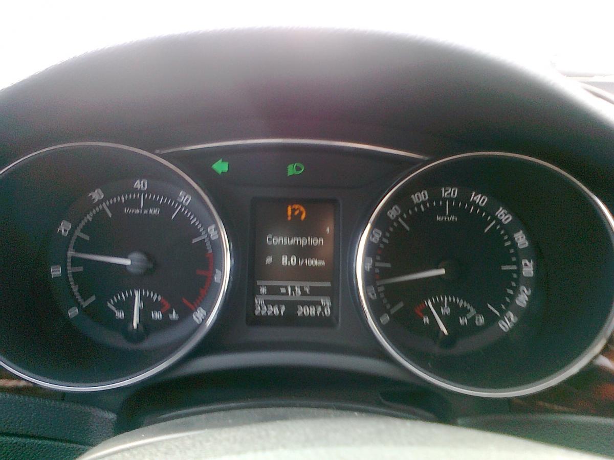

I had same problem while the car was only 10.000 km. I topped up to 1 liter of oil in less than 1000 km with same observations made by you: clean engine, no smoke. My engine code is CDAA which seems to be produced by AUDI and installed by Skoda only for Superb Estate version. After some time to observe the oil consumption and the oil low level warnings the decision was made by Czech manufacturer to replace the oil pump while the local dealer refused to accept any correction on warranty.
From the repair I experienced no problem at all, but still I top the oil level with not more than 300 ml for 15.000 km. Oil that remain after regular maintenance.
Additionally I mention that I use only Castrol SLX Professional Powerflow Long Life III 5W30 or newer version Castrol EDGE Professional 5W30. My 2010 Superb has now 62k km and no oil consumption issues.

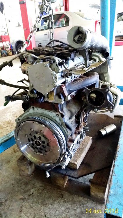

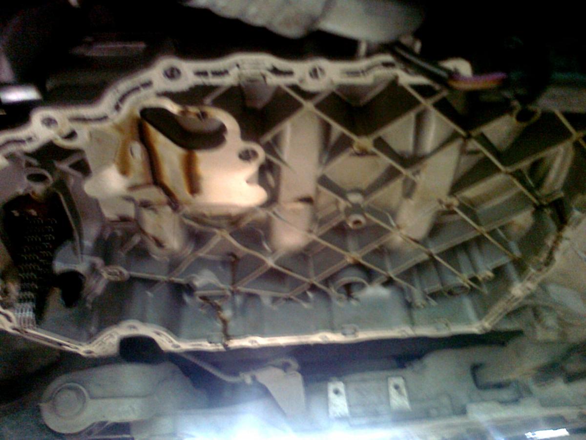

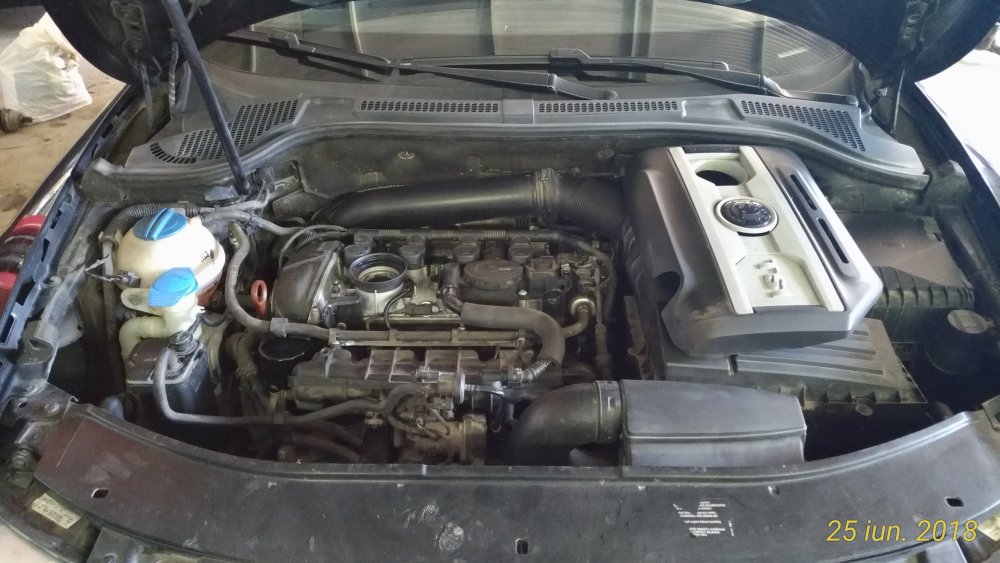

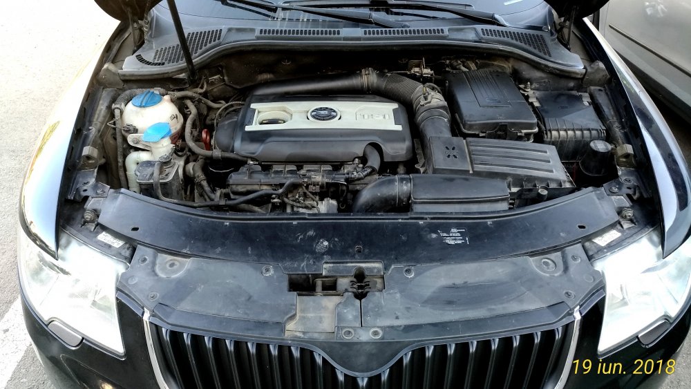

Absolutely, you're right there is no connection so far, but things changed after. I believe that oil pump was replaced due to frequent false oil level warnings that required no oil to complete the level. It was a desynchronization of the oil level sensor that becomes inactive when the engine pass 4000 rpm and the pump increase the oil pressure.
The oil consumption problem appeared for not more that 5000 km and disappeared after the oil pump has been changed.
Edited by safari hunter
One question.... When does it hit -1.5 degrees in Liberia? (4th photograph)
Well it's a very short story but not very important on this website :giggle:
'Freak weather, I guess' - I'm happy to stick with that explanation!
Intrigued to see the oil pump location in the 1.8tsi - post was worth it just for that.
