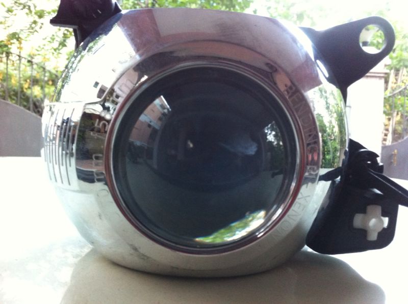

You need to trim the inner plastic frame of the headlight (once you take the original projector out you can clearly see) and trim the projector bowl tabs slightly - this is only so you can get it through the hole at the back. If you decided to do a really good job you could bake the headlight, open it up and no cutting of the projector is needed, you could also paint it all black which would look awesome!
As a guide the projectors are here - but they're LHD (these are actually an upgraded version of the E55's)

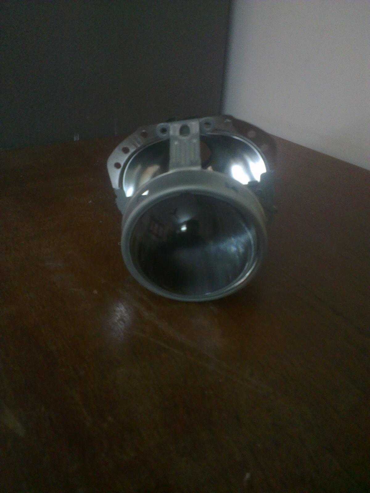

Sorry to keep bugging you mate, but I need some help modifying the cutoff to RHD. Instead of removing the whole piece and replacing it with a custom piece, I want to shave off the cutoff to make it flat. What do you think?
The only problem with doing that is it will never be flat. What will happen is the cut off line will be slightly wavy and this will be amplified when the bulb is lit (the cutoff will be wavy and blurred in places)
The colour hue at the cutoff will also vary along the line (closer the shield is to the bulb the more blue the hue will be, further away the more yellow it will be)
Lastly this won't work as the shield is curved, so it can't be flat. It must go up at the edges where it goes away from the bulb.

You need to specify RHD if you can, I got them cheap as they were LHD so I modified the shield cutoff.

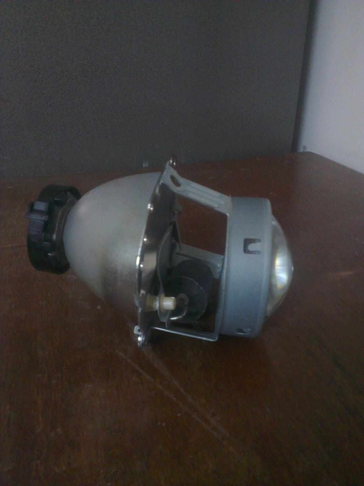

As far as the projectors are concerned you don't need to modify them (this includes the bowls) they will almost bolt straight in and use a D2S bulb. You will need to trim the inner frame down a little to make room for the solenoid at the bottom.

The E55 mounting points are the same as the originals but you will need to cut a slot in the plastic frame to allow the solenoid to fit (sticks out the bottom of the projector a little).
As the the LHD to RHD - the cut of shield is just a small piece of metal in front of the bulb shaped with a step in it. I just cut this off and replaced it with a flat piece of stainless steel plate, this way the beam pattern was flat.

I bought my projectors back in December but just had the time to get the bi xenon setup sorted this weekend. I followed Xpower's guide with some slight modifications and they fit snugly.

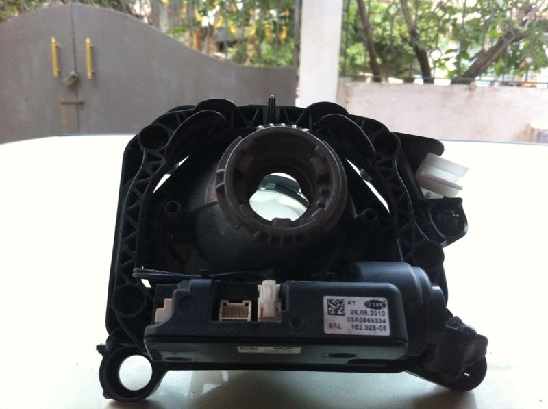

First, I cut two slots in the plastic trim outside just like Xpower did. Unscrew the 3 Torx screws holding the OE projector and just wiggled it out using the cuts in the plastic to work as a flap. I didn't need to make any cuts in the OE projector.
This next stage is where I needed some help and had one of my old Skoda technicians help out (he works at Jaguar now). Thanks to his knowledge we were able to trim the plastic frame inside for the solenoid to fit perfectly and wire the pigtails to the high beam from inside the headlamp housing itself. If you tug at the H1 wires, they flow through the main housing to the 36 pin power connector, so we just looped them there instead of drilling a hole in the high beam socket to lay the solenoid pigtail through.
We had to dremel the bi xenon slightly around the edges in order to wiggle it inside the headlamp housing. The mounting points were the exact same as OE, so there was no need to further align the projectors.

It is pretty straight forward if you follow xpower's guide. It took about an hour for each headlight, since I already got the OE projectors out the night before I started working on the bi xenons. Also, see the pictures I attached of the plastic frame holder to see how to trim it to accommodate the solenoid.
I got a LHD projector myself as it was cheap and tbh I messed up trying to make a custom cutoff. Try to get on HID Planet and see if some of the JDM guys can send over any spare RHD cutoffs they might have. That is what I did.
First you dremel off the rivets on the side of the projector and take it apart.
Then you have to dremel the LHD cutoff and fit in the new RHD cutoff in the same place using the same hole/mount. Mine says JAPAN on the cutoff shield.
Then I used nuts and bolts to close it back and hold the bowl and lens together.
