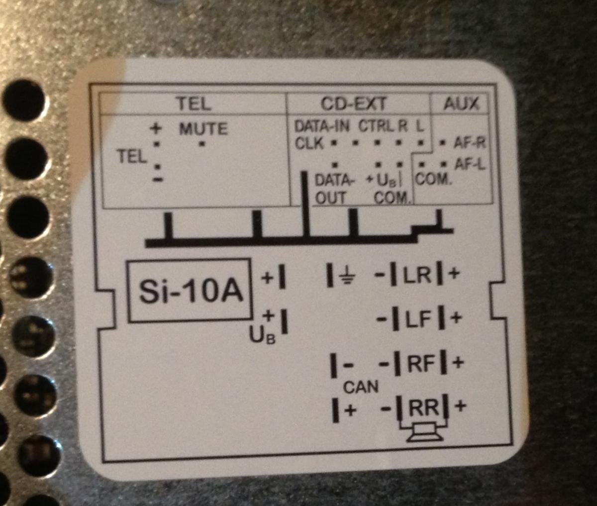

I'm installing a third party BT handsfree kit, has a mic on it and a line out. Today I've removed my radio (Blues) to hide the wires behind (attached to the aux-in) and came across the sticker on the radio saying "phone", has three pins, according to the sticker + / - / mute.
I don't remember having read anything in the users manual about phone handling. Do you guys know what these phone pins mean (what are they used for?) and how the Blues radio is supposed to handle the phone?

I took a pic of the sticker on the radio: post-101983-0-23071000-1365451621_thumb.jpg
(I was wrong at the original post, it doesn't say "phone" but "tel". Wonder if I was ritht that these are for the phone...)
