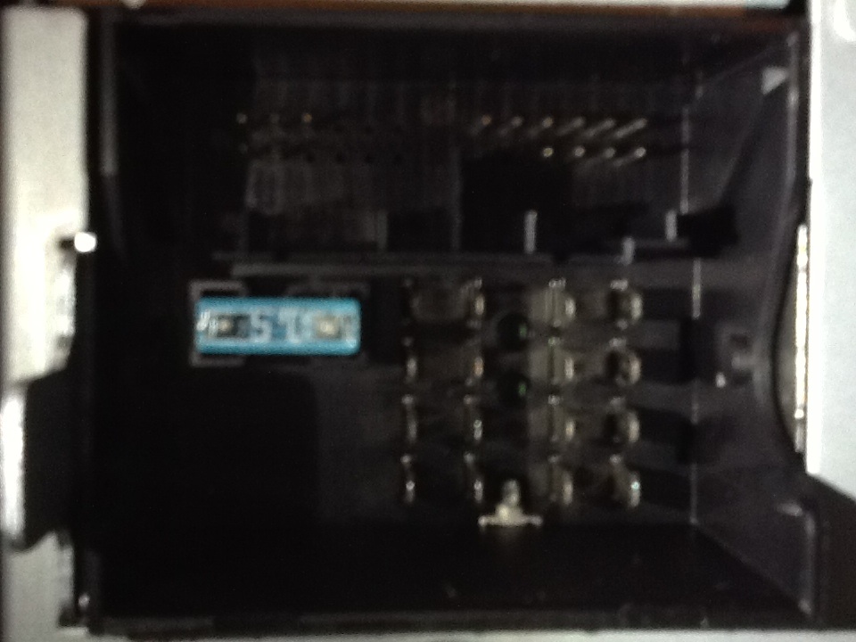

Update just had a look at the back of the swing and it would appear that there are not pins all the way along the top of the unit so on way to connect mic to pins 1and7 or am I missing something.

J18vrs do you have a pic of the rear of your swing unit?, there are a couple of different looms 1 with voice control and the other without
i will get one tomorrow and post it up i seem to remember seeing some wires going in to none pinned holes on the back of the stereo but cant imagine why that would stop the mic working as i assume that would be wired in to the BT unit itself

The mic pins should be attached to the current loom. If you're handy with soldering you could do that yourself, but first google it up which wires you'd have to fiddle with. I got my kit from carsystems.pl that included an "in between" loom for plug and play.
Right finally got round to getting a picture
now the only thing i can see that could be my problem is the two sets of black and clear wire pairs that appear to go nowhere as there are no pins in the radio

ha ha success turns out the loom i have is for a radio with voice removed the two sets of black and clear wires joined them together and bobs your uncle one fully operational BT system

Update fully working now the loom was wired incorrectly and mic polarity was reversed! :)
