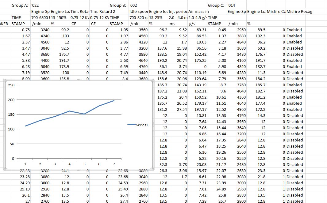

MAF reading not looking to healthy !!!, thats from 2260 rpm up to 6000 rpm
post-8833-0-64824600-1360150536_thumb.jp
Heres part of an old log I found from 2008 this only revs to 4960rpm, note the much higher MAF figures at lower revs
post-8833-0-67011100-1360150771_thumb.jp
It's still not right, big boost drop Sunday third gear on a slip road, dropped back to 5 psi, Mpg still low.
Looking at these numbers it's pointing towards MAF plus possibly with added boost leak fun !!
