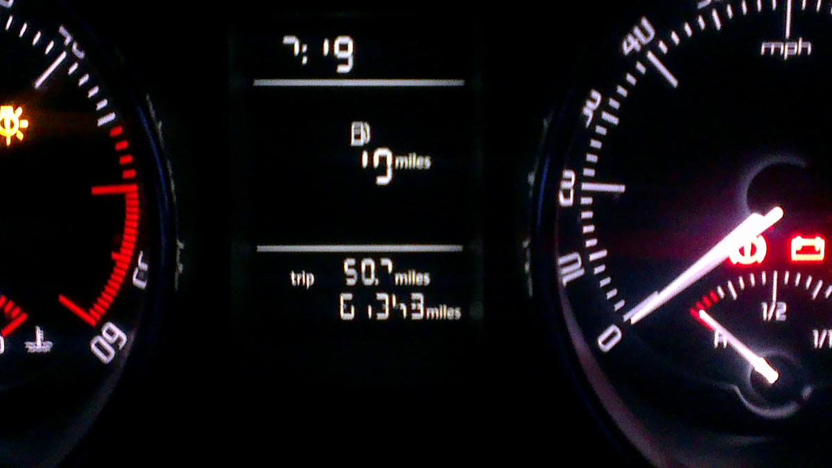

Hi everyone i own a skoda superb mk 2, I love it best diesel i driven so far (im a taxidriver and ive driven a lot of different diesels) im looking for help with the lcd multifuntion display in my superb, its not displaying properly a lot of the characters are all of a sudden missing. Wondering the best way to fix this out of warranty

The only fix is to replace the whole instrument cluster, and this has to be done at a dealer.
You could try BBA-REMAN who could possibly repair it, but since you need to send the whole cluster away to them you'll be offroad whilst its being repaired.

Thankyou so so much for putting me on to bba reman you've just saved me roughly about £400.
