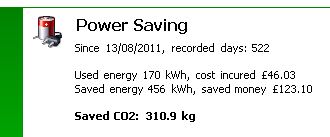

The only thing thats a letdown on these servers is they dont support S3 standby - only option is hibernate.
I have WHS2011 (which is just win 2k8R2) and use a plugin called LightsOut this monitors specific IPs/machines for activity, and hibernates the server when its not required - then WOL is used to wake the server up again when it receives an access request.. according to the stats it keeps, its saved me over £125 in electricity over the two years ive had it.
