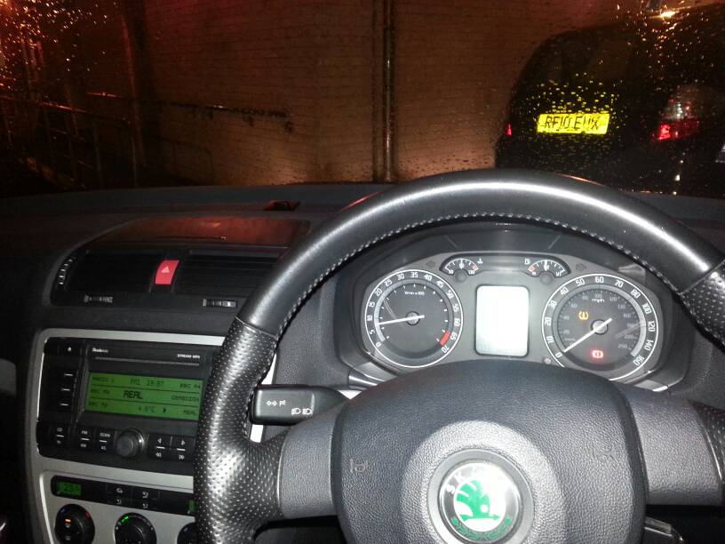

You can turn it on and off (I think) using the stream head unit. In the settings there is an option for "Beep On/Off". Have you turned it off by accident ?

Stream headunit..which one is this, im getting really confused with all of them now! lol
Stream is the CD auto changer fitted as standard to pre-FL vRS's. Attached a pants picture

Oh i didt know that you could turn the beep on/off via the head unit..how please?
