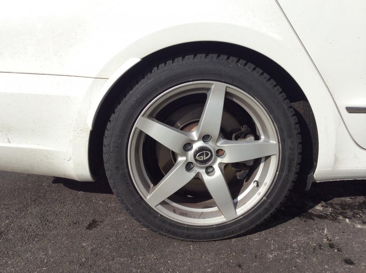

I'm running 17" winter alloys on my 3.6 and there is lots of space behind the rims for the standard brakes. Looking to upgrade discs all round at some point and will go a bit bigger. Photo below for info.
The photo is from your rear wheels! These have smaller brakes than the front wheels. If you would look at the front wheels, you would find out that there isn't so much space between the caliper and the rim.
Correct andrehj - my rears are 312mm and the fronts 347mm in diameter (310 and 345 quoted standard discs). The fronts still have at least 25mm of space (50mm total) though before any interference with the rim on the 17's.
All that said I'm a newbie to the Skoda (although I have tinkered with many cars over the years) so happy to be advised as I'm keen to learn about the Superb :)
Dave
Regarding the Callipers are you referring to the offset rather than the diameter? Offset (distance from hub) should be a constant unless spacers are used (which are not recommended). Callipers on mine are standard units (as are the discs).
Dave
Sorry about that - I misunderstood the point about the Callipers. There is still around 20 mm from the leading edge of the calliper to the inside edge of the rim on the front....
