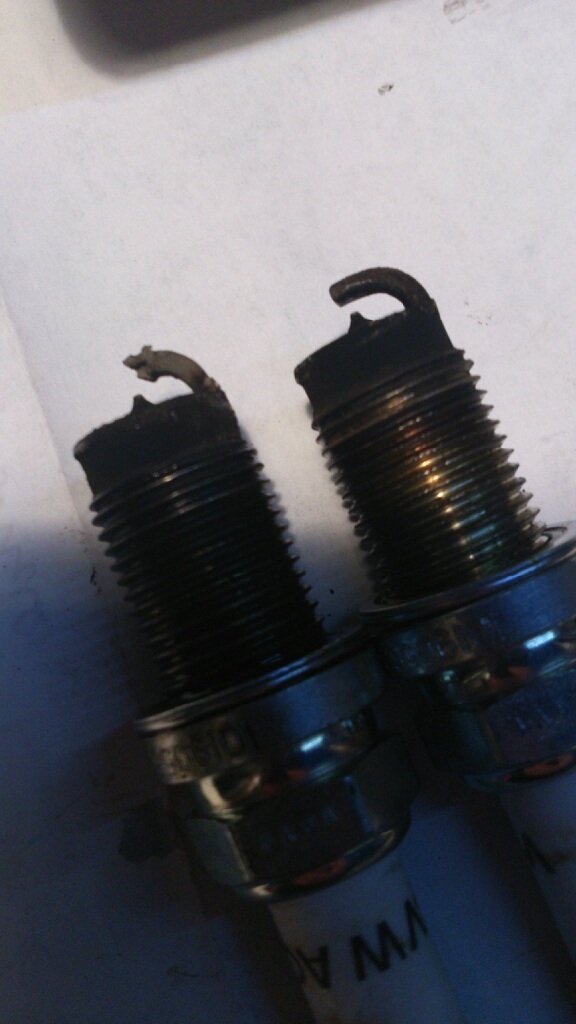

My spark plugs went at 19k miles and they are surpose to last 40k and I use shell VPower,

Vrs fletch,did you have to pay for your spark plugs?????
No, I refused to pay for them as they are surpose to last 40k and I phone SUK and told them that I'm not paying for something that has not lasted the desired time they say its surpose too. I also have a on going problem with oil consumption, had the dreaded engine light and limp mode kick in so phone skoda a assistance and the mechanic show me the spark plug out of cylinder 3 and told me to take it to the garage, post-90108-0-52290900-1360794795_thumb.jpg
they are not right, i took my standard plugs out at 40k and the looked like this...
plus as others say it should run on 95RON, it shouldn't wreck your engine....
