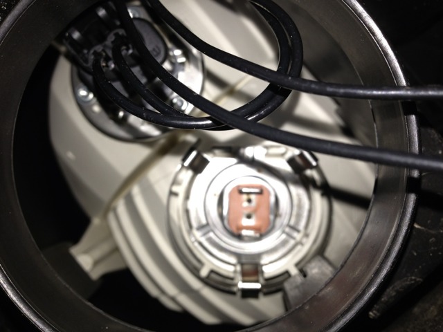

I need to replace my offside fog light, but can't work out to remove it.
I've looked at the manual, and can't find what it is that I need to push down to release it.
Any sensible suggestions welcome!!!!
Sent from my iPad using Tapatalk HD
Just the bulb, Mike?
Twist the silver retaining clip prongs.
If its the entire unit, let me know and I'll check on Elsawin?
Just the bulb. It has blown.
