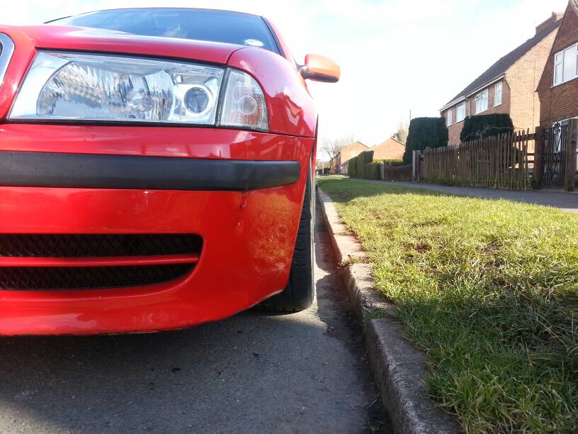

I had it in at work today as i noticed the nearside front wheel was sat in an inch at the top. After looking close at it i decided to go down the cheaper option and replace the shocker for a new one hoping that would cure it, but it hasnt. We believe its the hub thats bent, how its happened we have no idea.

Tryed a new shocker today and still sat in at the top of the wheel. If i put it on a ramp at work and look at the gap between wheel and strut, i can get one finger between on passenger side and two fingers on drivers side. Theres about an inch difference. When its sat on the ground you can tell really bad

Whats camber like on wheels then
I will put a picture on tomo so you can all see. Cambers not very good really.

Slight camber??
Sent from my GT-I9300 using Tapatalk 2
Slight camber??
its kinda hard to tell from the pic, though it looks perhaps like a tiny bit of camber, but mabe thats a placebo effect, as i know you are having issues so i can see it if that makes sense.
however, the hubs are cast, so not likely to bend, the associated parts, ie wishbones, struts, or subframe, would bend/get damaged before the hub i would imagine. Is the strut fitted in the hub properly? has it had any suspension work lately?

as said, i doubt its the hub, these hubs arent threaded either, you have a top and bottom bolt holding the strut, with a locating tab, just wondered if that was out, as if not the strut wouldnt be correctly seated in the hub

Cant see any accident damage, i tryed a shocker on and it was still the same. Bottom arm measurements are correct. Think im just going to have to stick this hub on and see what happens. If its not shocker or hub then the only other thing to change would be bottom arm

Hmm if all you can tell is the gap between each arch and tyre is different and you have checked lower wishbone, camber, is ok both sides, no shock strut damage then maybe the wing has been replaced and was put back slightly different to other side.
