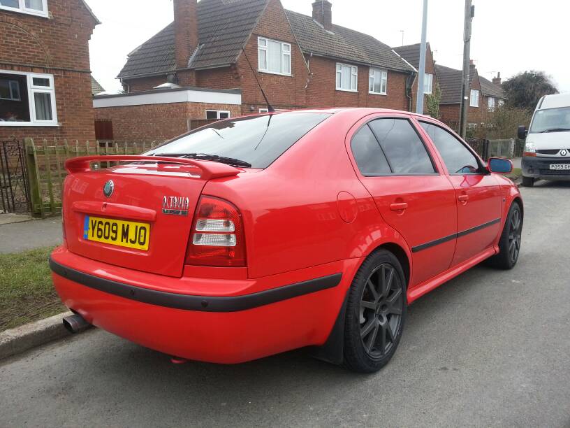

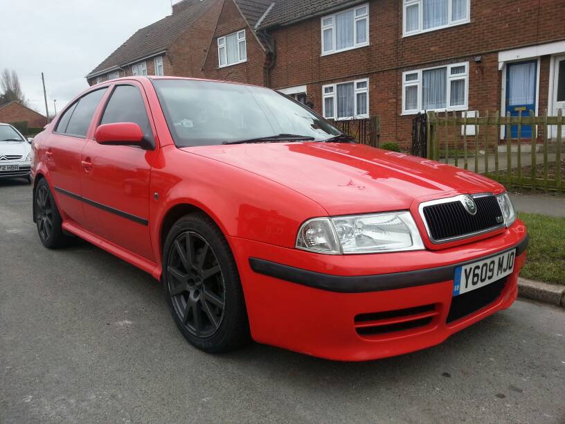

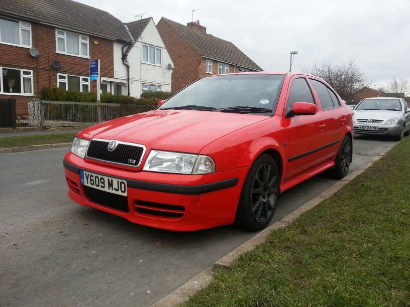

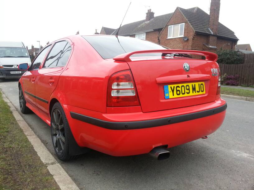

I beleive the wing genuine, the gap between the inside of the wheel and the strut on pass side is about a finger and the gap between the drivers is two fingers. If you look closely at pass side you can tell its sat in where as drivers side looks correct. Heres some pics, dont know if you be able to tell by these though.

Might be a daft suggestion but have you checked the springs there might be part of a turn missing which would give you your gap/camber differences
Yeah had it all stripped at work on friday, hopefully a hub will sort it, if it is the hub i will be amazed but there cant be anything else as its all been checked. Looking at it today it doesnt look to bad really but ive just put 4 tyres on and dont want them to end up like the old ones on the front. ( Racing slicks)
