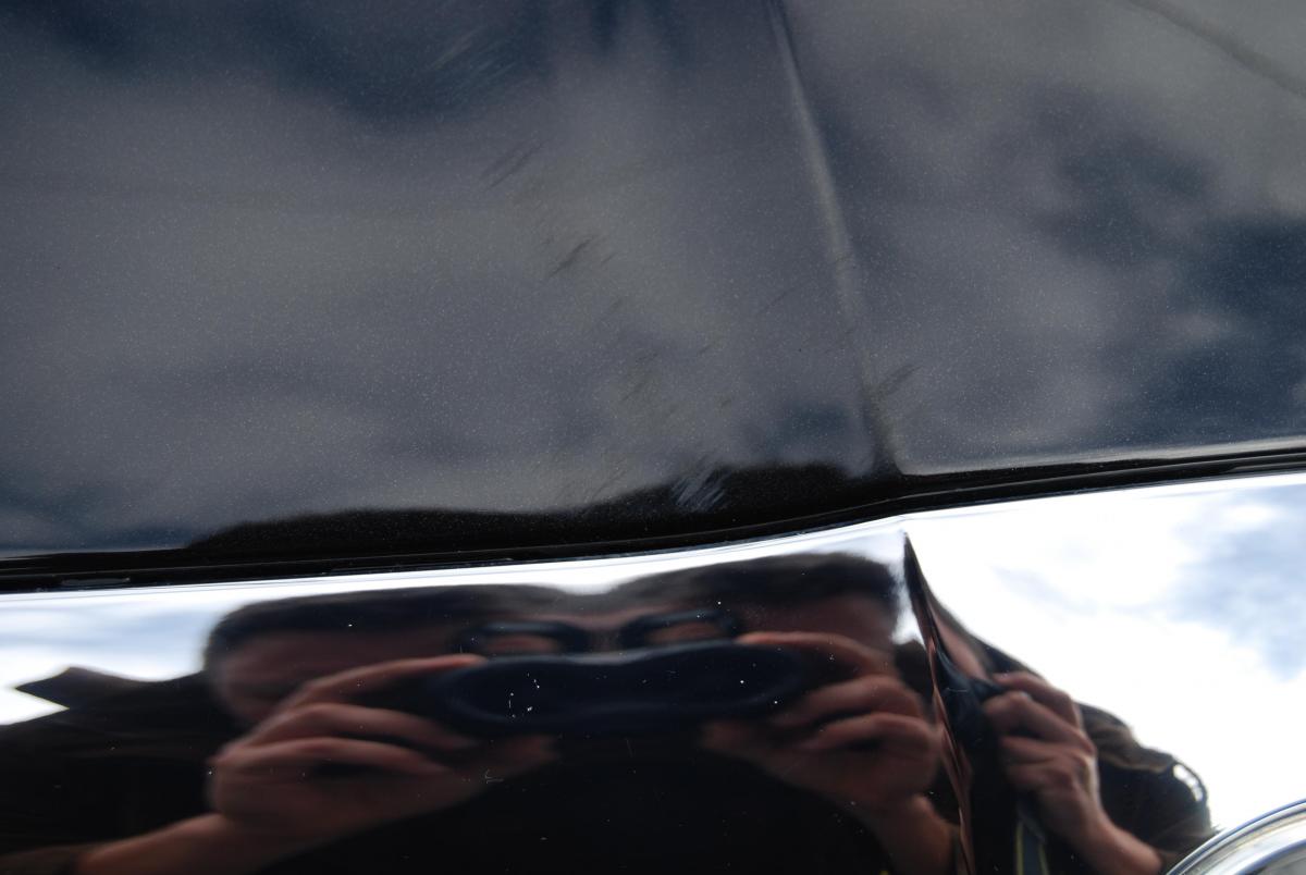

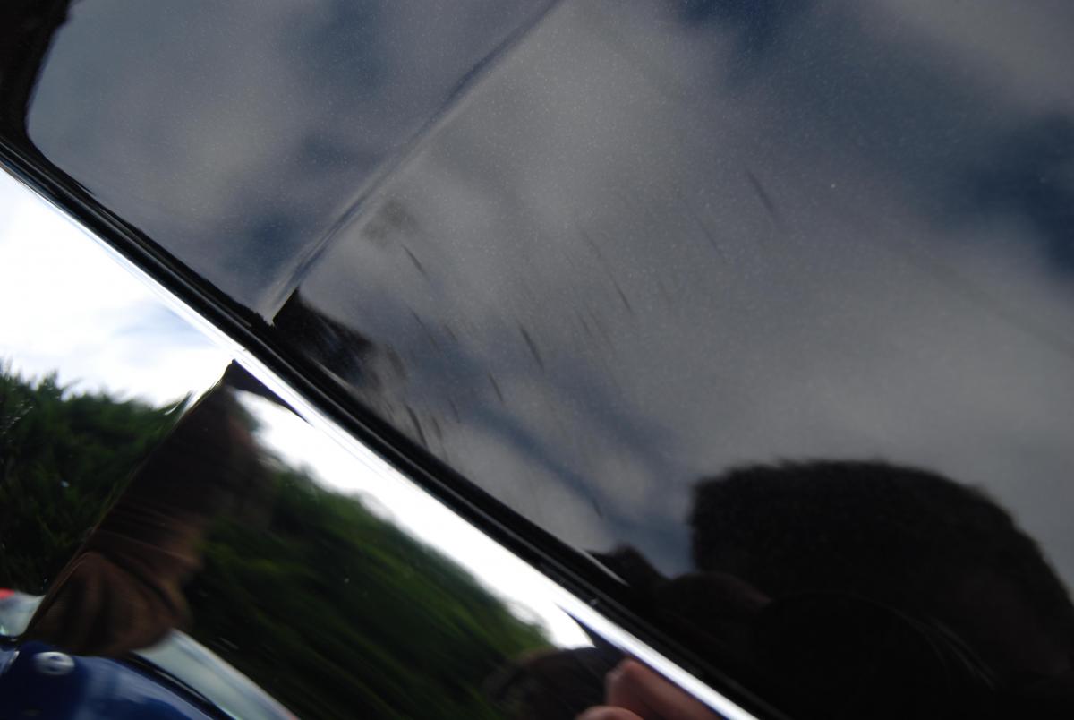

Now the day went really well but this morning I went to remove the ribbons from the car and found this...
Due to the weather today I have been unable to check over the whole of the bonnet properly or the mirrors but its fair to say that I am a bit gutted :@
I have tried a quick go with some AG SRP and it has cleared some of the lighter marring but there are some definite scratches. I will have to try something a little bit more abrasive when its not raining! I really did not expect ribbon to be able to damage paintwork- its relatively soft, the sort that you can buy at a florist.

It is when the ribbon buffets in the wind that does the damage, what you should have done is place a thick piece of sponge under the front to lift the ribbon off the paint and then tied the ribbon to the roof rails… again making sure that wherever the ribbon could touch the paintwork was protected.
I doubt whether SRP will remove them it has fillers in it so they will appear to have been reduced, but once the SRP has been washed off the scratches will reappear.
Ideally you need the bonnet polishing by machine.
I doubt SRP will get rid of that either, but pretty sure a DA or rotary machine would polish that out. :thumbup:
As above. SRP will just hide some of the scratches rather than remove them (it does remove some I give it that), put your going to need something without fillers so you know where you stand with them. Do you have any other polishes. P1 with a tri-foam pad would remove these easily.

You will need to polish polish polish and it WILL come out - I used black color magic followed by PoorBoys Black Hole then some Collinite - gone!

Machine polish or DA will be the easiest way to remove those marks, you will have them not on on the bonnet but also on the A-Pillars and around your wing mirrors.

It could have been much worse. You can't believe how much damage polyester-based ribbons can do when they get wet or if the roads have been gritted, they can turn into sandpaper :(

Damage doesnt look to bad to be fair it would be easy to get out by a fine polish.

Looks fixable, which is good! A good machine polish should whip that off with no issues.
Like previous answers, a little machine polish will remove the marks with no issues. :)

Wow, I had a chance to get out today and what a result. The P1 that Svend sent me has removed all of the damage by hand using a foam applicator. I am seriously impressed with the results and very grateful for Svend sending me the product. So much so that I have splashed out and become a freedom member (I know that does not give anything back to Svend but im really impressed with the friendly atmosphere on here). Thanks for your help
