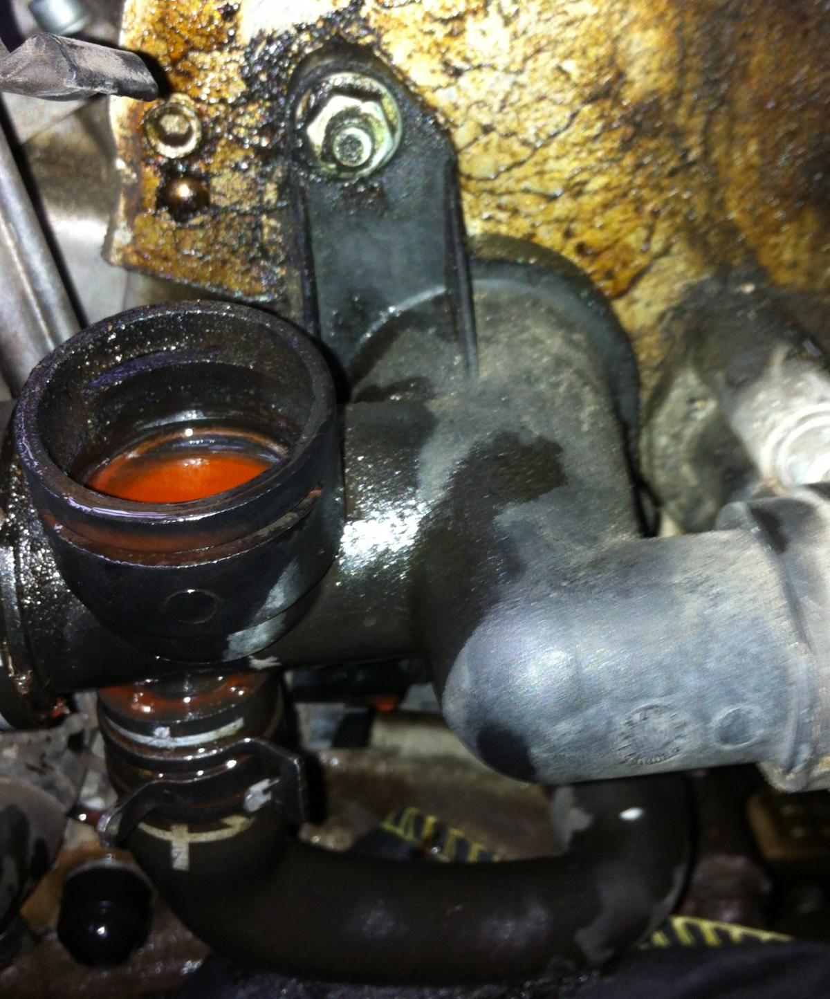

fairly sure the leak is coming from around the housing of the hard plastic joiner in the pic.where it meets the block
would there be a gasket between the joiner and the engine block?
gave the 2 nuts a small tighten but dont want to snap one off(did this before on sump)
if there is a gasket i doubt its ever been changed so could be the problem or there could be a small crack..didnt take it off yet as i dont have the coolant to replace what im going to loose
I would be suspicious that it could be that plastic joiner connected to the head where sensor goes and hoses join to.
Seen these wear and cause a water loss.
Sent from my Galaxy S3.
If this is like the housing on a vw polo which has the temp sensor etc and pipe connections, I replaced the housing and it sorted it, It was about £25 from gsf, It has a rubbery gasket that detterated and leaked.

looks like that the culprit. defo not any or the hoses as was dripping down onto them
couldn't really see with all the crud down there now but I was thinking gasket between housing and block could be causing the leak. heading to Skoda garage tomorrow so they can pull it up on ETKA diagram
certainly sounds as you suggested thanks
just back from Skoda. there is a sunken gasket between that joiner and block but ordered the housing too only €14.10
when replacing the flange with sunken gasket should i be using gasket sealant too or ok on its own
also is air locking a problem after replacing and if so any suggestions to fix thanks

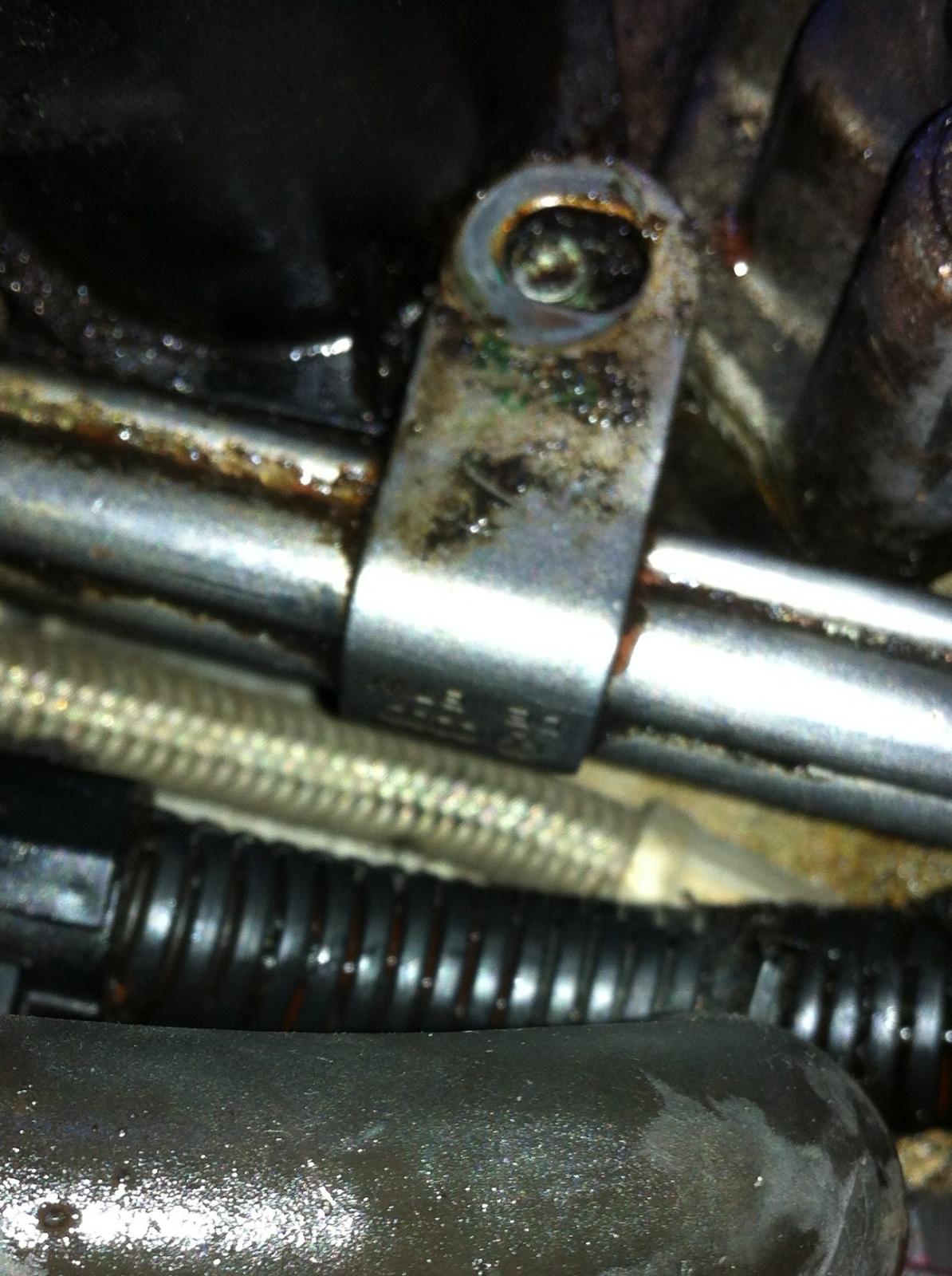

theres 2 nuts holding the flange on. bottom one also holds this little bracket which in turn are holding i think those 3 metal lines..are they fuel lines??
i cant seem to get tis bracket off without bending it outwards but dont want to damage anything further
was just reading threw manual and seems they might be oil lines going to a servo,bit beyond my pay grade :o
should i bash on bending or is there a more subtle approach im missing!? thats usually the case so im told!
ok new joiner on hoses back on too. do I need to bleed system now..
Id let it run with the expansion cap off for a while until the thermostat opens.

ok will try that thanks
ran it for about 15-20 mins. had to top up coolant straight away but fans didnt cut in. would it take longer for fans to cut in or could that be dodgy t-stat
Ive rarely seen the fans kick in on mine. Should be fine, drive it and monitor coolant level.
hit 90 degrees and stayed there and no sign of leak coming back again,YET,so fingers crossed that's sorted it!
