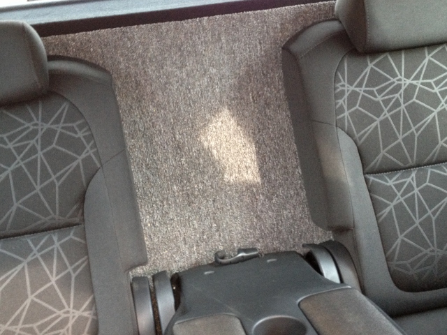

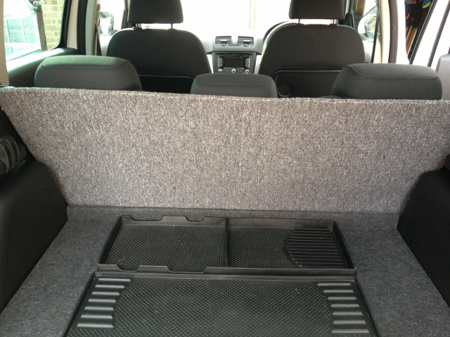

I have always been concerned of marking the armrest pads with stuff in the boot and also that using the armrests leave the boot contents exposed from both a safety and security perspective so....
and from the front
It's just carpet folded and stuck....melted the edges with a blow torch to stop fraying
It's not fixed in any way but is retained by the parcel shelf and the boot floor (spare wheel type)
If I drop the seats the carpet can just lay over the top of the seat backs so its quite versatile

The cover is 1120mm wide at the top, 990 mm at the bottom. It's 630mm high.
I tapered the sides in from midway down
Here is photo with it removed from the car
