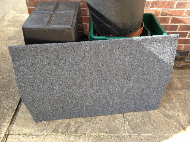

The cover is 1120mm wide at the top, 990 mm at the bottom. It's 630mm high.
I tapered the sides in from midway down
Here is photo with it removed from the car

Just to update you on this subject. I made a cover over the last weekend using your measurements. The only difference I made was to add some lightwight board between the carpet and hot melted glued some binding fabric (sides) and rubber at the base. A length of velcro at the rear and it gripped the parcel shelf perfectly. Photo's as follows:
Looks very professional, nice one.

Great job it does look like a professionally made part, would it be possible to give a bit more information about the materials used and method adopted.

When the seats are dropped flat I use the blind to protect the seat backs by just laying it on top. Works well.
Measurements are in post 21 above and I have described how to make one. Happy to add any detail you need just ask....Nigel

I have added a strip of velcro along the back which adheres to the tailgate cover and stays in place when the seats are dropped blocking of the boot area, but as Nigel states you can pull away and lay on top of the rear seats for additional protection, best of both worlds

I did update mine to black carpet and used a thin ply stiffener as per jonceebee.
It looks neater but not being as flexible is also a slight compromise in ease of removal and no good if you want to split the seats etc

Whilst the mark 2 rigid looks better, the original mark 1 is slightly easier to live with if you drop the seat often
