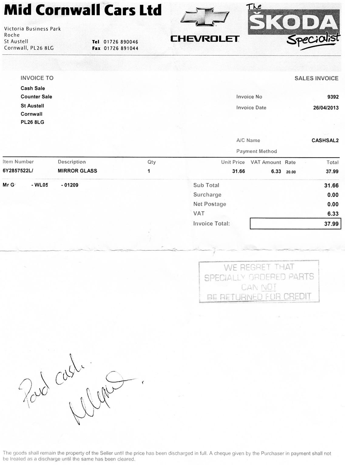

Having my O/S drivers door mirror ejected with force and smashed, from a door mirror on a Peugeot 206 going in the opposite direction (by woman driver not stopping).
Not cheap to replace (£37.99) as the mirror has a printed circuit on the back for heating.
If it's just the mirror glass you can find one on eBay for approx £10
