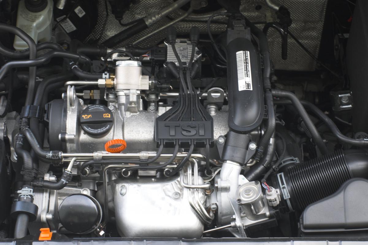

Ours is a December 2009 1.2 TSI and various warning lights popped up on Sunday and 'go-slow' mode was engaged, I've just taken it to the local Skoda dealer and it was diagnosed with a fault on HT lead 3.
As in the above thread this appears to be a heat related issue and the newer HT leads have protective shrouds as a result. At just over three years old but under 30,000 miles ours is out of warranty but low on miles.

The small amount of extra protection can be seen on original lead 3 here (clearly not enough):

Agree with Michael G, you should raise it with SUK as the newer engines do have additional protective sleeves over the HT leads, so clearly a design issue.
Standard HT leads on our previous 2010 Fabia TSI, protected leads on the replacement 2012 Monte.

Looking at the new cable it is abundantly clear that it is not a re-designed, 'new' cable. The extra sleeve is just that: a length of corrugated sleeve that is presumably put in place before the ends are put on the cable. I strongly suspect that it would be possible to modify an existing cable using a slit or coiled sleeve and this would cost pennies.

Looking at the new cable it is abundantly clear that it is not a re-designed, 'new' cable. The extra sleeve is just that: a length of corrugated sleeve that is presumably put in place before the ends are put on the cable. I strongly suspect that it would be possible to modify an existing cable using a slit or coiled sleeve and this would cost pennies...
My take on it was that whilst the lead per se had not been re-designed, the addition of the thermal sleeve constituted an updated design, most likely as a result of the failures you and I and others experienced with the unprotected original in the TSI engine.
