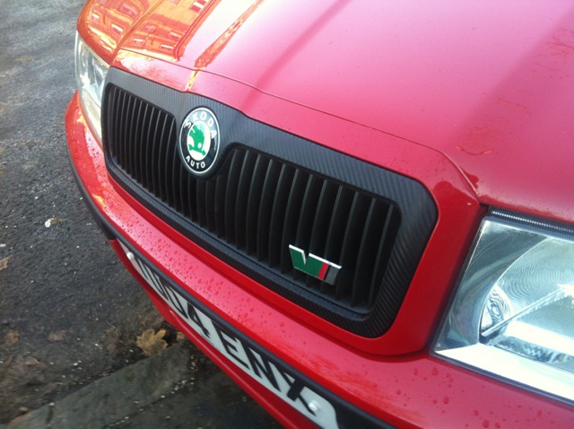

Mine is wrapped. Takes longer than Plastidip but better chance of avoiding chipping. Cheap too, £4 is enough to wrap two grills.
261B540A-572E-4F1B-B434-0DD8984D3C27-341
Can you explain this wrapping please?
Sent from my HTC One using Tapatalk 4
It's just a sticky backed vinyl that you apply to the grill and 'wrap' it around the grill itself. Easy to do with a hair drier to help you stretch it into place.
