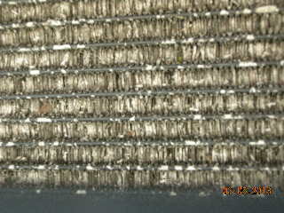

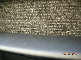

Why you never mention the price if the repair done out of warranty? Is the condenser build in in main radiator? My radiator badly bitten by stone chips just right under the tumber plate grill, in same time the cooling system works good , no loosing coolant etc
maybe this is the problem?
I bought the car from the company but front radiator is bitten by stone chips, where they were use the car i have no idea.
look on picture please
