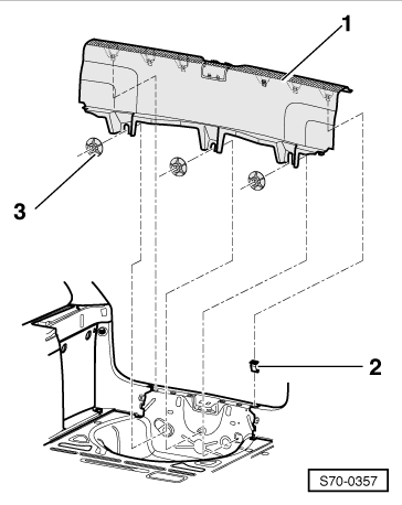

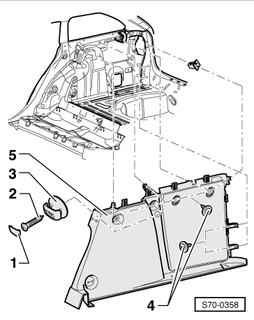

Here's the details for an estate rear bumper, I don't have any for the hatch, but I guess it's broadly similar.
Not difficult, just time consuming due to the amount of interior trim and lights that need to come off.
Getting it back isn't too hard either.
post-59543-0-26635900-1369170171_thumb.gifRemove rear bumper.pdf
Cheers KBPhoto, will assess tomorrow and see whats best, might wind up a garage job to be honest but will have a butchers anyway
