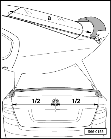

Found this info on Elsawin if it helps:
With there fitting instructions:
Applies for vehicles with new tailgate Install the pin screws into the spoiler.
Position the spoiler in the specified position: a = 824 mm (measured from the window edge to the spoiler edge). Centre the spoiler on the tailgate. Press the spoiler evenly, until pin screw tips are pressed off in the paintwork. Make holes (Ø 6 mm) for screws on the points marked by the pin screws in the spoiler. Remove pin screws. Clean holes and protect against corrosion.
Thanks for the replies guys - looks like a mk2 spoiler may be a tad too big.

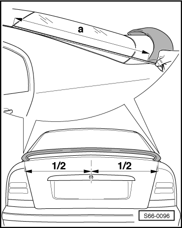

Hmm the MK1 Octy VRS on Elsawin doesn,t show a good picture spoiler wise.
Remove dowel sleeve -1- and clips -2- from the spoiler. Clean the seating area of the spoiler as well as the tailgate with universal cleaning agent -D 009 401 04- while observing the instructions for the adhesive cement issued by the manufacturer. Apply the adhesive cement all around the spoiler while observing the instructions issued by the manufacturer. Push the spoiler onto the tailgate (4.7 ±1 mm from the tailgate edge to the spoiler edge). The dimension 4.7 ±1 mm must be the same on the left and the right side of the tailgate. Secure position of the rear apron with adhesive tape. Remove any dirt present using a cleaner.
Looks or at least sounds like the above could be a lip spoiler, surely it's not glued on?!
Yes sorry about that as thats a lip spoiler forthe 4x4 sedan.
I found the VRS hatch MK1 spoiler:
Fitting etc: – Screw the pin screws into the spoiler.
– Position the spoiler in the specified position: a = 867 mm (measured from the window edge to the spoiler edge) – Centre the spoiler on the tailgate. – Press the spoiler evenly, until pin screw tips are pressed off in the paintwork. – Remove spoiler from the tailgate and make holes for screws on the points marked by the pin screws in the spoiler. – Remove pin screws. – Clean holes and protect against corrosion. – Clean the seating area of the spoiler as well as the tailgate with universal cleaning agent while observing the instructions for the adhesive cement issued by the manufacturer
