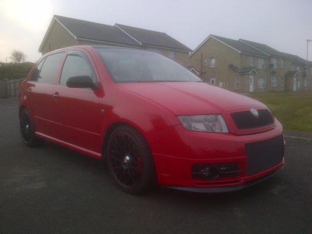

HI I HAVE A 2005 FABIA VRS RUNNING ROUND 220BHP
HI I REALLY WANT TO CONVERT THIS TO 4WD I WORK IN A M.O.T CENTRE OWNED BY MY BROTHER SO TOOLS WELDING ECT AINT A PROBLEM CAN ANY1 GIVE ME A LIST OF WHATS REQUIRED? CHEER
