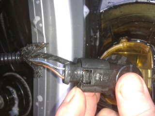

  • I put a sharp thin tool down the back of the terminal & pulled the wire out of the plug. Swapped the wires round then refitted the terminals into the plug. Not difficult once you have done one.

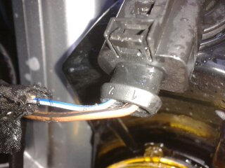

Just remove the terminals and change their position. Refit in opposite way. So the Brown ends up where shown in term' 1.

Carlo,
can you be more specific than down the back of the terminal. I've tried that and mine won't budge 1mm. Which point is the clip? Is it by the number, or 90° offset?
thanks
Kevsta you need to remove both wiring terminals from the Black holder. Seen in picture as term 1 & term 2 are shown on the black plug..
These two wires with the terminals need swapping from 1 to 2.
Some one suggested to just cut both the wires & re-joined them about 2" up from the plug to give you room . (no probs if you wonna do that). Then solder up the join. Or straight in line crimp terminals. I have loads...
I removed the whole term from where it says 1 & 2 from the Black connector.
First you need to prise out the waterproof sleeve in the black connector where the wires enter, as just pull them out & push them up the wire out of the way.
Second a Sharpe probe needs to go down the side of the wire & in turn down the side of the term' to unlock its tag, then pull out wire & term' together.
Then just change over the wire positions as 1 goes into 2 & 2 goes into 1.
Simples.
If you need further info PM me your number I will call back.
CD

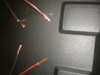

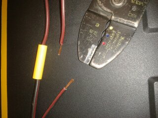

Here you go.
Remove the lamps, remove black wiring plug from lamp body.
Aprox 3" away from plug cut the 2 wires.
Bare off the cable ends as in pic.
Fit single In Line Connectors as shown &  change over the wires, 1 goes into 2 & 2 goes into 1. . crimp.
That's all there is to it.

Here you go.
