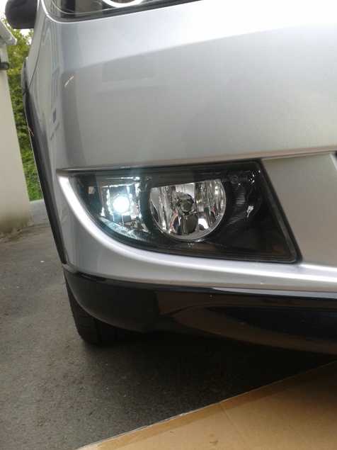

Fitted them tonight after I got back from work. They work fine, no problems and look great in my opinion. I think they look more noticeable, and finish off the front nicely.
Don't seem to dazzle from the angle I was looking, but only time will tell. No re-wiring needed, no fiddling about, just in and they work. No error's on the dash either. Pictures are below.
They look very good from the front, but I'm guessing that the camera is not replicating the true colour on the side views where the lights appear to be yellow?
I took the pictures using my iPhone 4S. I do agree the original bulbs look lighter in person, and the camera has added some tint to them (the standard ones). But I'm happy with the end results of the LED's.

Avtur, have you made the mistake that I made first time I saw the pics?
Basically, I think Stufans three pictures are i. Before, ii. Mid-way through the change, iii. After changing both bulbs, hence the light in the first one looking quite yellowy i.e. it's the normal bulb.
Am I right Stu?
PS. They are sort of a bit dazzling. More pics at different time of day/ lower angle/ further away/ projections against a wall/ reflections in a window might be more telling. I guess LED lights aren't meant to have reflectors normally? Carlo's look less conspicuous (which is possibly counter intuitive!)
