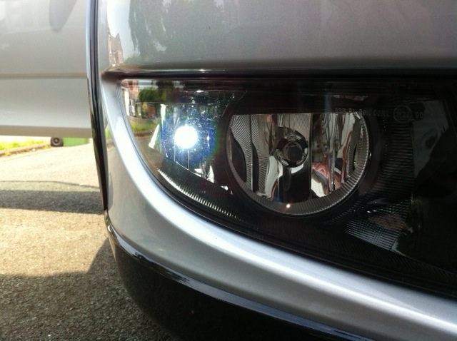

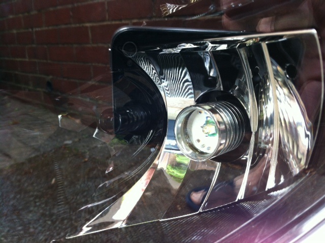

I've changed the drls and sidelights to CREE bulbs and they are just awesome. I have put pictures on another thread you should go have a look the links to the sellers are all there too.
