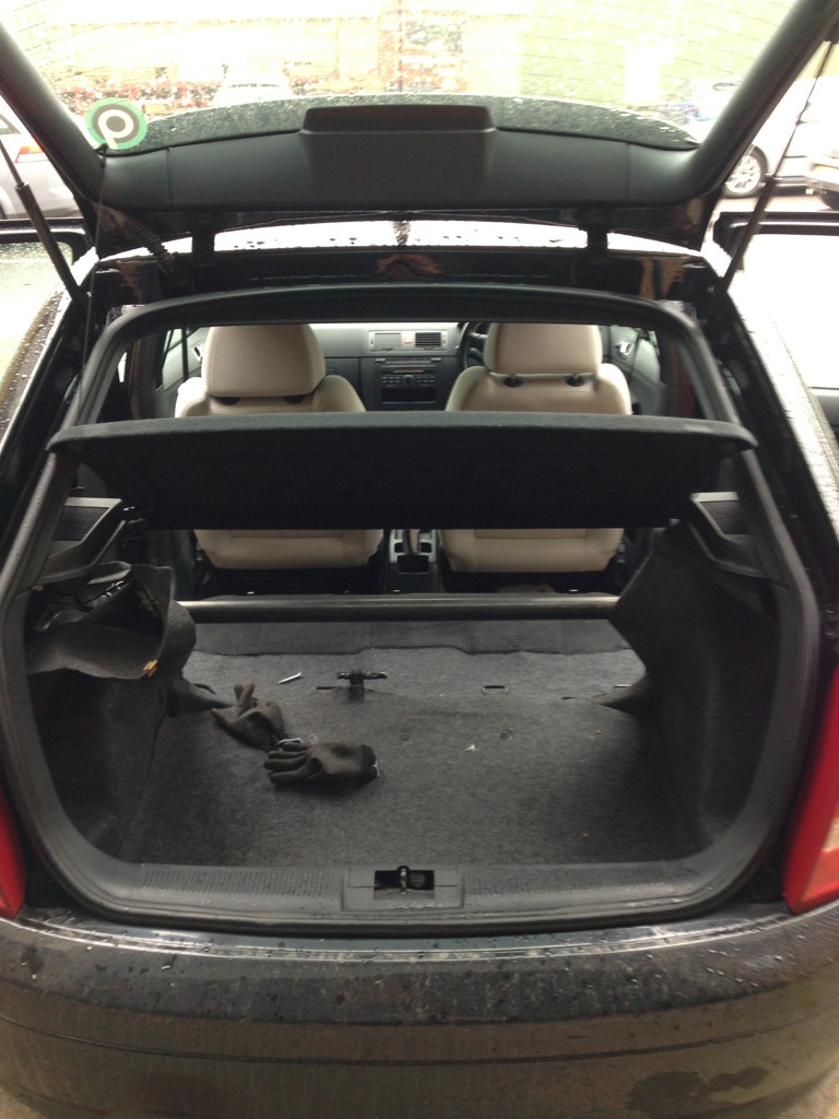

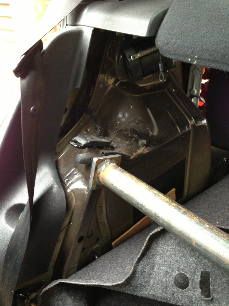

Well I was a bit bored at work today, was a really quick job and I know the size of the tube isn't really ideal but hey, it fits and works ! Made it out of 42mm tube ( free from work :p ) two 10mm plates on either end with an M8 captive nut welded on each side, like I say it was a quick job will probably try get some thinner tube and give it another go ! P.S the edges are rounded now as well.

I like the chunkyness of the tube it makes it look purposeful. Is it just wedged in there tom?

it was in the Instagram photos Joec just spent about 45 minutes fiddling on to get the bolts in what a nightmare !! Got it on going for a spin now.

p.s it does feel a bit firmer into the corners too.

I presume the back seats still fit with the thicker tube lol

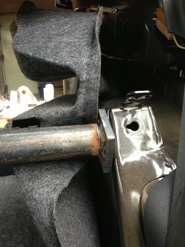

Can you put up a pic of the ends of the brace where the fixings are?

haven't actually checked that as I have them out anyways, will check over the weekend and get back to you

i didn't get a photo of that mate, basically just a 10mm thick plate with a 10mm hole drilled into it and then and M8 nut welded onto the plate and obviously that's welded onto the tube
